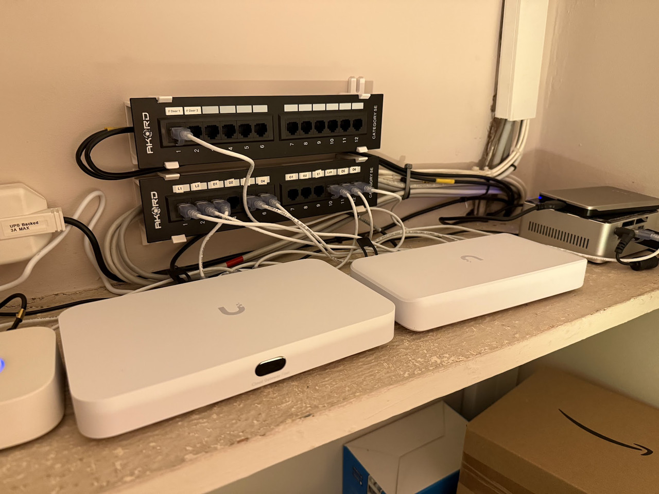

Check that the UGC-Fibre supports enough cameras for your plans. Is the internet connection symmetrical? You may be tickling the limits of the UGC-Fiber, and might want to consider bigger, racked mounted devices.
Also note that your APs have 10GbE uplinks but the UGC-Fibre only has a single 10GbE / SFP port. I have mine uplinked via that to a separate PoE switch
Just got the UGC-Fibre myself so looking forward to that, in time I will move protect off it onto the their NVR.
The UGC-Fibre has two 10Gb SFP @GeX while one on the data sheet is assigned as WAN you can move that and free up both SFP for internal use.
The UCG-Fiber still only has a 10Gb backplane though from what user tear-downs and testing have revealed, e.g. while it can do an amount of network switching, it's not designed to be a network switch and you could see network bottlenecks.
From what I've understood, the 4x 2.5Gb RJ45 ports are connected to a Realtek hardware layer 2 switch chip which is then connected to the SoC/CPU via a single 10Gb uplink. The 10Gb RJ45 port hangs off the side of the Realtek chip via a 10Gb uplink and is only connected to the SoC via the Realtek chips single 10Gb uplink. The SFP+ ports are connected directly to the SoC/CPU with no layer 2 switching chips in-between. The bottleneck in all of this is the single 10Gb uplink between the SoC and the Realtek switch chip. You've basically got 20Gb of connectivity on both sides of the SoC/CPU with only 10Gb connecting the two sides together! Once you add in SoC overhead with WAN traffic (routing, NAT, IDS/IPS, Firewall etc) or layer 3 traffic and that bottleneck may get bigger.
I'm not saying it's not possible to use the SFP+ ports for internal use, but you need to give some thought to how you can optimise connectivity between devices and the WAN. It's why the general recommendation is to connect the UCG-Fiber to a dedicated network switch such as the 2.5G Lite/PoE. If all of your devices are just 1Gb then it's likely a non-issue :p
