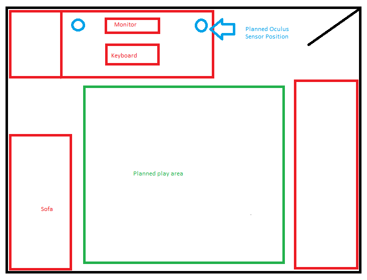

Hey all,
I'm planning on sorting out a new VR setup for my computer this weekend, as I've recently changed my desk setup - However, I wonder if I will have some problems...
Here's my crude floorplan :p
The thing I'm wondering is... My desk is not central to the VR area, so the sensors would need to be turned to the area, rather than pointing directly forward.
Would this still work?
Thanks,
Marky
If you can, you'd be better wall mounting the sensors in diagonal corners of the room, though that requires at least one extension lead which can be tricky to get working. I used sticky dash-cam mounts for my three sensor setup.
If you can't wall mount then yes you will have to angle the sensors into your play area. Moving the one on the left into the corner and angling it at 45 degrees may be better. The one on the right might be ok pointing forward as it has a wide field of view.
If the oculus setup complains you can always skip past that to try the tracking out anyway. Really though you need a third sensor for decent 360 degree tracking (or a Rift S!)
The sensors use a 1/4 20 thread. So they can mount to most tripods and stands. Might worth using a tripod, or wall mounting one sensor in the corner as @Ravenger suggests.
Thanks for the comments guys - I did eventually get the setup working with the sensors on the desk but it definitely isn’t ideal...

Just get a wall mount and put it right up in the corner, use d-line trunking (corner stuff if it’s in the corner) to conceal the cables. You can paint the trunking if you like.
In my three sensor setup, the front two are about 4 meters away, and the rear one is 4 meters away from the front right.
As to the mates, who cares? I have a three sensor setup in my office, it’s a talking point for clients :p Trunking hides the wires very well, so all you see is the sensors, and the front of their mini tripods.

Not sure on the Oculas sensor setup but I know the Vive ones work well in a diagonal orientation. Before I redid my setup the front sensor was right in the corner and I realised I was losing tracking because when I bent down to pick something up in VR my hands went behind my desk. It was actually quite funny to see one of my controllers float off in to distance.
So I'd suggest trying your original idea and see how it works. If you have issues move your sensors and test again. Only way to be sure is with trial and error I suppose.
I use an almost identical set-up with my Rift. I can sit at the desk or stand in the off-set play area and the tracking works fine without adjusting the two sensors which sit at each back corners of the desk. Works fine for me.

D-line is the best looking imo, it’s rounded and offers corner profiles. As you say, once painted it’s barely visible. I can understand why someone wouldn’t want it in the living room, but if that’s your play area then your options are limited. Perhaps the Rift S would be more suitable for @Marky.

I've put the sensors further away from each other on the desk, and the performance is much better :)
