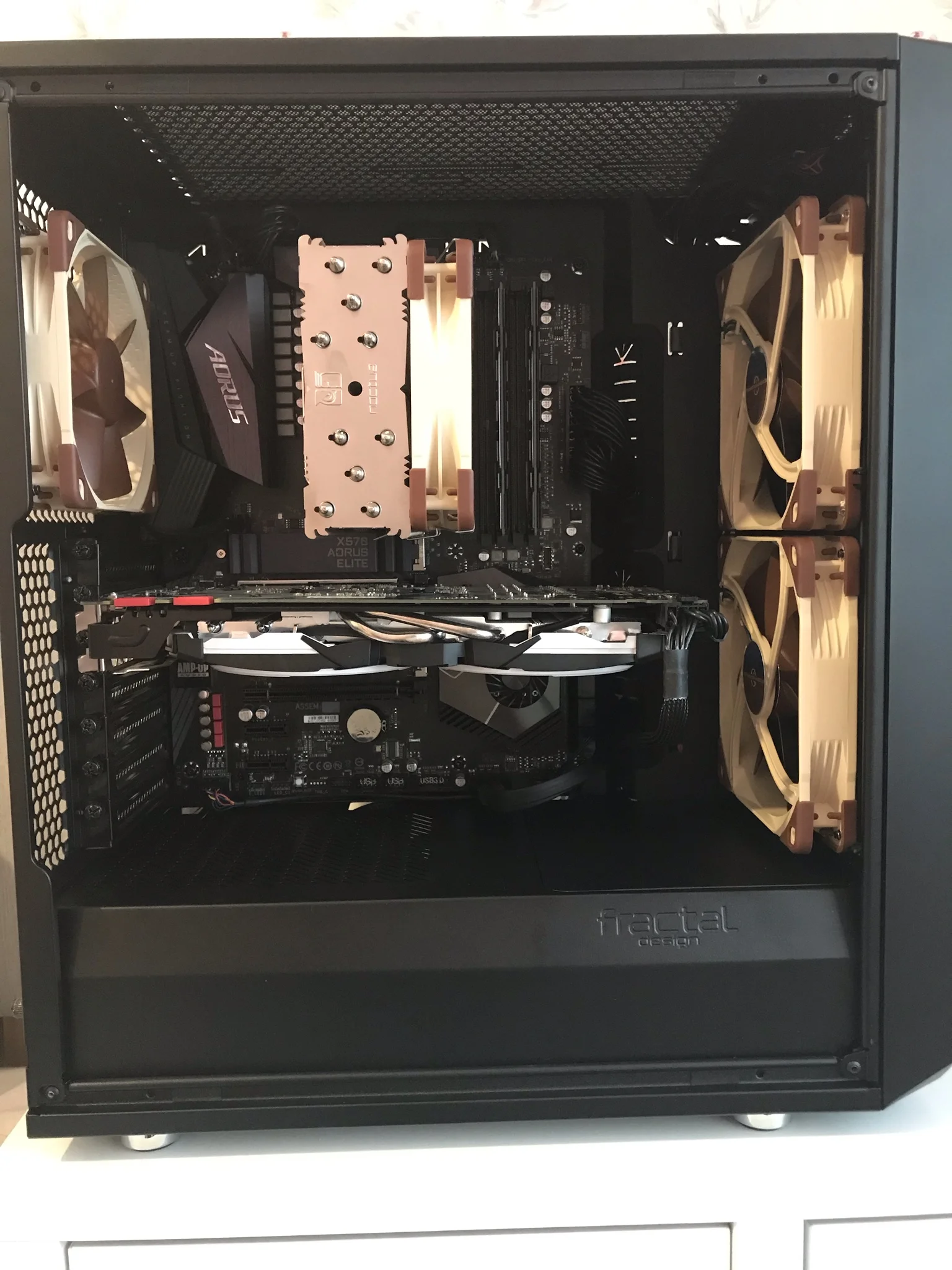

I've just built a new AMD Ryzen system using the Noctua NH-U12S SE-AM4 which is the AMD only version of the cooler. As you can see with my pic it's quite a compact cooler yet powerful and you could add another fan to the rear
of the cooler making it a push > pull dual fan config.
That's a very tidy install, nice work! I see you have Noctura case fans too? Which graphics card is that in there?
