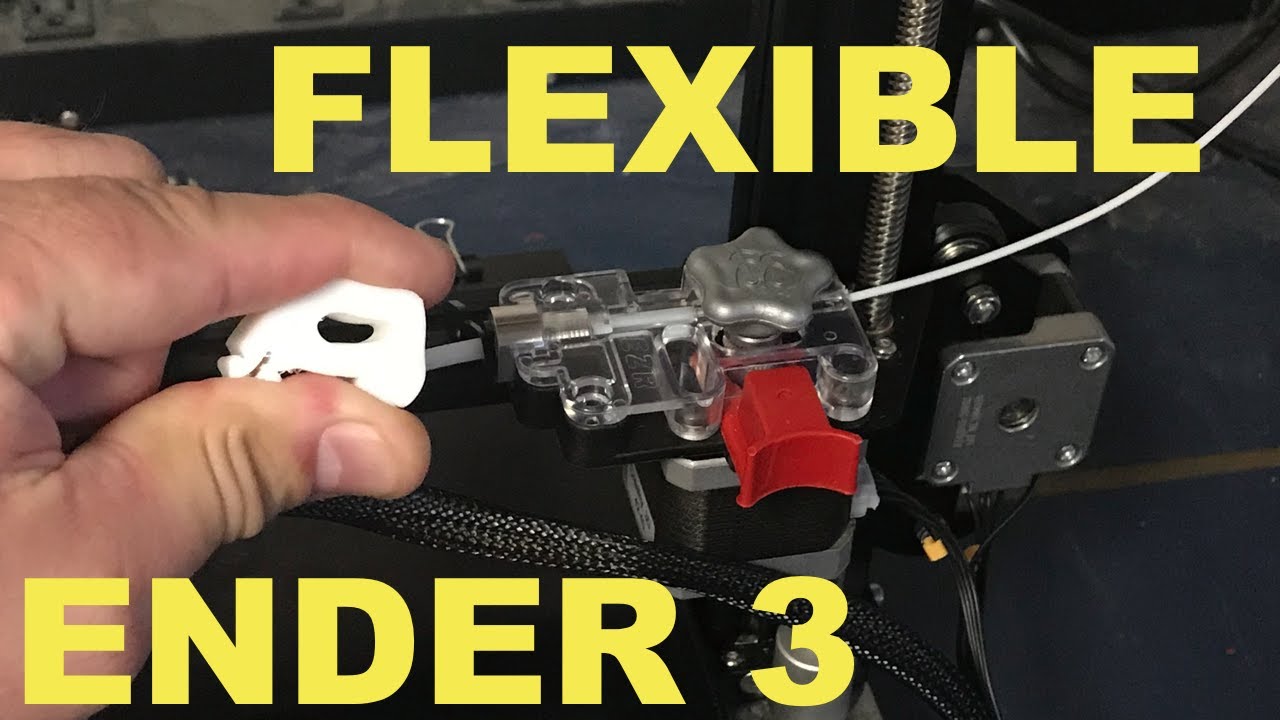

I have watched a fair few of CHEP's videos, and even went as far as to print the new extruder top from his previous video on the subject, but then I was getting under extrusion as the arm wasn't putting enough pressure on it, I suppose I could try that again with a different spring, but as I had the E3P to play with I figured I'd play with the DD option.
