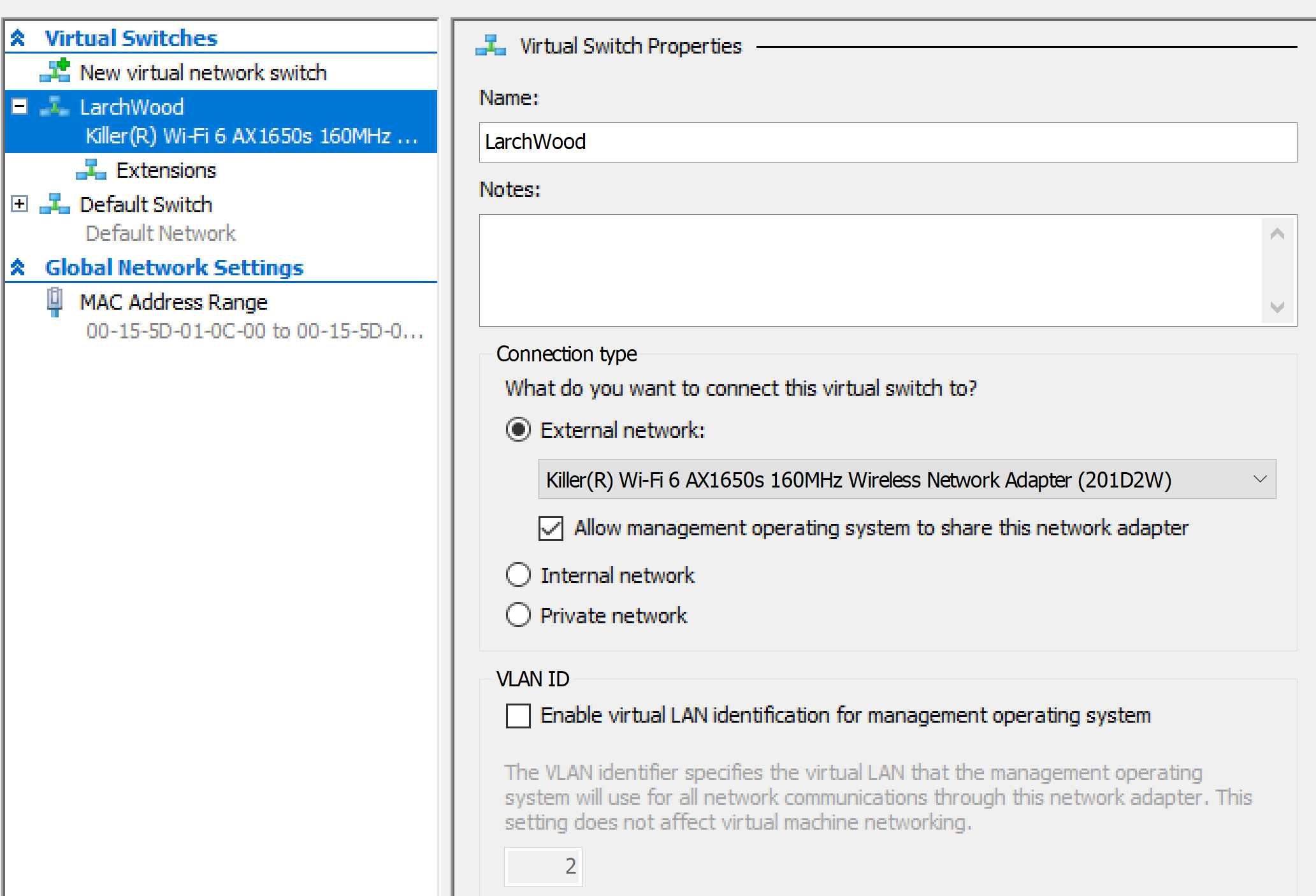

Create External switch in Hyper-V Manager which is tied to your network adapter > add network adapter to VM and make sure it's using the external switch > set IP address in the VM, the gateway will be your router and the DNS will be your router but you can add something like Google DNS (8.8.8.8). Should be that simple. You don't need to touch any settings on the host, just in Hyper-V Manager and on the VM.

Critically, whatever network adapter you use must be the one that actually gets physical internet on the host. Is your host using WiFi or LAN?
Here's my config, none of my VMs that I want to have Internet use have static IPs (all DHCP from the v-switch). If I change SSID on my host WiFi, the address on the VM will change too.
Exactly what I have done @Pigeon_Killer and mine looks the same as your pic @Django x2
