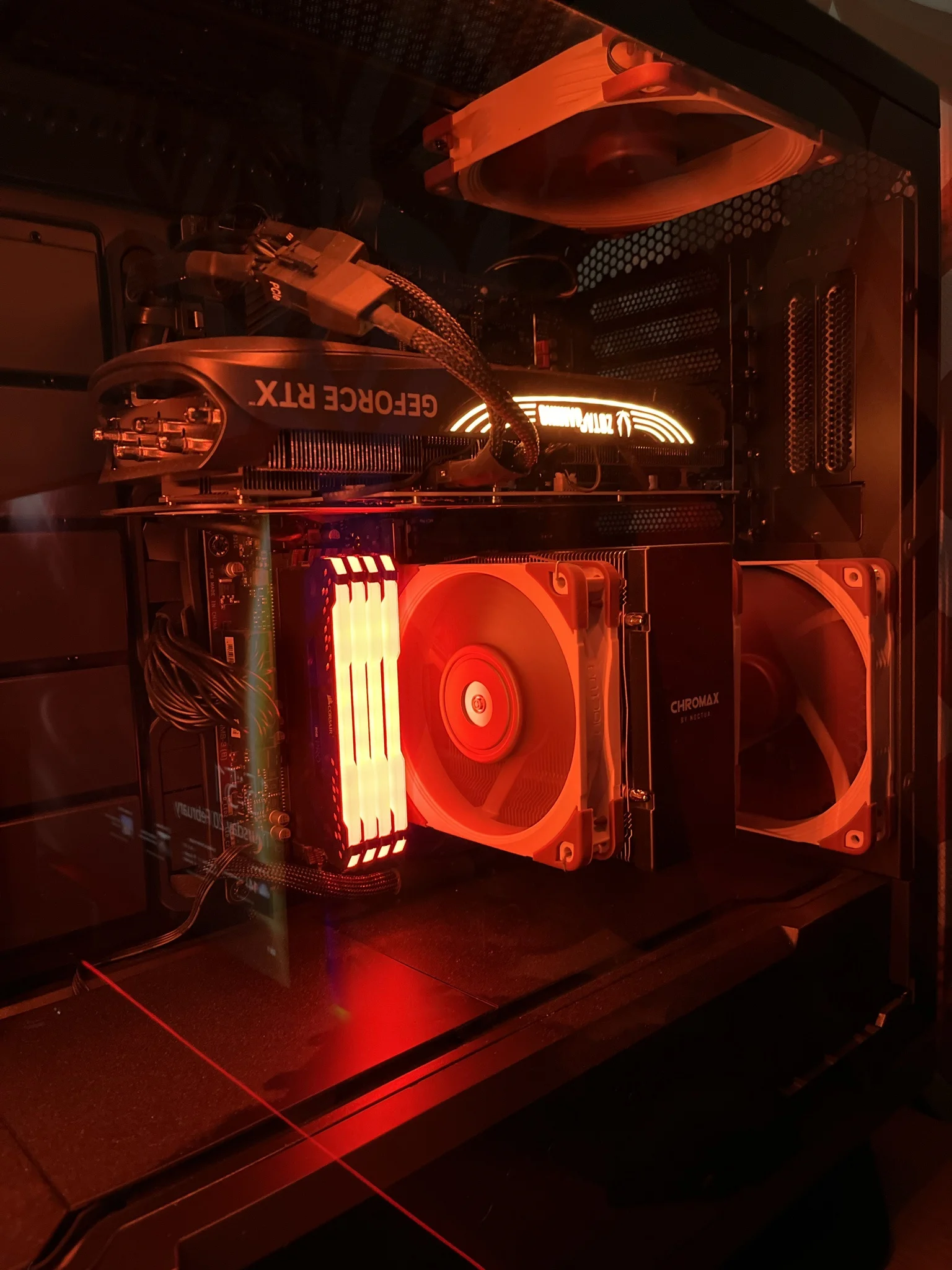

I have 3 x Noctua 140mm front intake fans, 1 x 140mm exhaust for cpu, 2 x 140mm top exhaust (added one since pic taken) for gpu hot air.
My case is a Bequiet which has been inverted so window on right.
