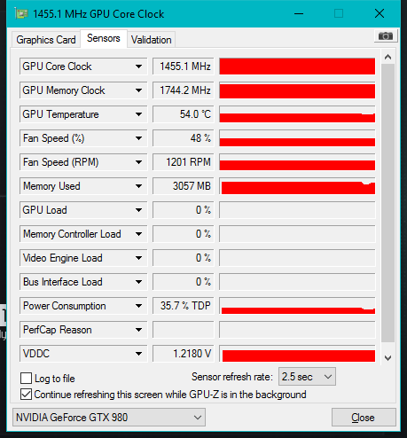

I have had a 980 for a little over a year now and it has never been such an ass of a job for the past year I have had to be dealing with TDR issues on every single game I throw at it normal computer use it is fine just when gaming.
The TDR issue is random sometimes it happens seconds into a game loading and sometimes I can play for over an hour without a TDR....Now this is where it gets weird I can run the Unigine Heaven maxed out for hours no issue temps in limit's as it's water cooled never goes past 60c.
As you can see the card is more than happy to keep pushing with boost 2.0 and with more increased power target it does keep boosting more I believe Voltage caps will be the limit for this card smile.gif This is the same story for when gaming everything stays within checks no spikes or anything.
My card is an Inno3D iChill GeForce GTX 980 stock clocks for this are shown in screenshot
As you can see I have tried already to turn down the default memory clocks to the stock Nvidia 980 to see if this was an unstable memory clock however on doing this it makes no difference I was still getting TDR problems this did not change when they happened either.

Do you have GPU-Z open when gaming? If so do you notice core voltage and clock drop down just before the crashes occur?
Tried updating your motherboard's BIOS? Both my HD5870 and GTX580 hated my AM3/AM3+ boards - I believe they were ASUS, can't remember the models though. Very similar behaviour to what you're describing.
Hi thanks for getting back I don't get a chance to check through GPU-Z when the TDR happens it stays on the black screen for a good 10 seconds and then it makes msi afterburner and GPU-Z reset and the readings get glitches to numbers in the millions Intill I reset the gpu in device manager.

Hi I can send a copy of the bios for you no problem but yes I am sure the cap is around that mark for the volts whowever if I use the evga tool or the MSI one I can push the volts much higher +87mv however I tried this tactic by smashing the volts up and it did not help all this did was make my card boost more and run hotter.
My ASIC is 78.5% which is higher than what I had on my old 980 HOF and that come shipped with same clocks on the GPU however that one had Samsung memory and this has hynix thats why I thought to turn down the memory clock to stock but didn't really help https://we.tl/DwGkaGfOwR

Ye it has a blower style cooler fan right over the VRM's and the there is a rather large heat sink on them as well
Mmmmm, is there any reason your memory clock is running at 1744?
Also try running it at 1390 boost
I would again run K Boost though to see if it makes a difference.
I wonder if you are running and unstable OC...

It's running that speed because the stock speeds on the memory are really unstable it tdrs seconds into a game.
I can't see it being anything to do with an unstable overclockers as I have even underclocked the gpu to 1000mhz gpu and stock 980 memory clocks and it's still crashed the same amount
So it is you who has underclocked the memory? That is where your issue will be. You absolutely should not have to drop your memory clock below reference or more importantly out of the box clocks. Do you any Firestrike scores as heaven is not good for this fault finding...
