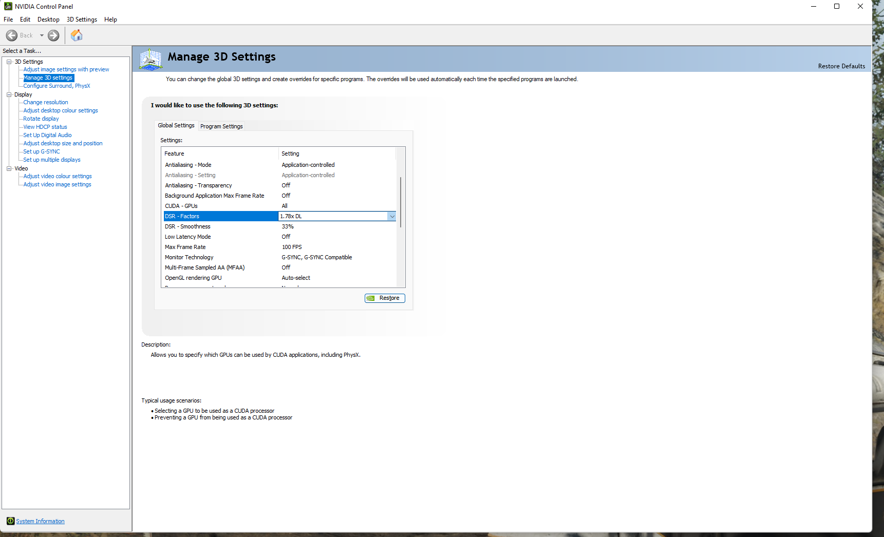

thought it would be cool to discuss DLDSR experiences here in 1 thread
All my images will be DSR 1.78x from 4K (5461x2880)

From what I've seen, the steps are.
  1. Go to the NVIDIA Control Panel, under 3D Settings > Manage 3D settings > DSR - Factors. This is set globally, not per game.
  2. Choose between 1.78x or 2.25x.
  3. After applying the change, you should not have access to a higher resolution option on the desktop and in game e.g. on a 1440p screen, using 2.25x, I now have access to 4K (3840 x 2160).
  4. You don't need to change your desktop resolution, just the game.
  5. Open the game and set it to the new resolution.
  6. Seems to work fine with DLSS.
