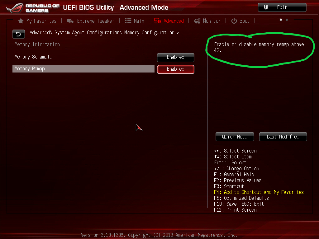

Some older Mobos may be able to get this via bios mod so long as you have a setting called "4G Decoding", it is either in Advanced or Boot menus normally (on my Z87 it is in the same menu as Memory Remap).
