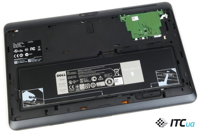

i have had a look at the back of mine to see if the ssd shows up there but looking at the other models, it seems like where the ssd should be, it has a little circuit board there. no idea what that is.
this is what mine looks like when i take the back off
il ty=ry take a pic of it without the black thing
In the worst case also that SSD has been soldered onto motherboard.
Though would be weird to have at the same time that easily replaceable battery.
Did you check what's under the battery?
That is strange as the disassembly video didn't look like that.
The video was for the 7139, so is this the 7130?
Yet NBC said the SSD was easy to replace. Maybe there where revisions.
Anyway, if it turns out to be the 2260 M.2 SATA only slot, then there is no meaningful upgrade you can actually do.

Anyway, I think we have come to the conclusion that your machine does not support NVMe M.2 SSDs.
However, it would still be useful to see what your machine does support as it was strange that under the back panel there as only the battery.
