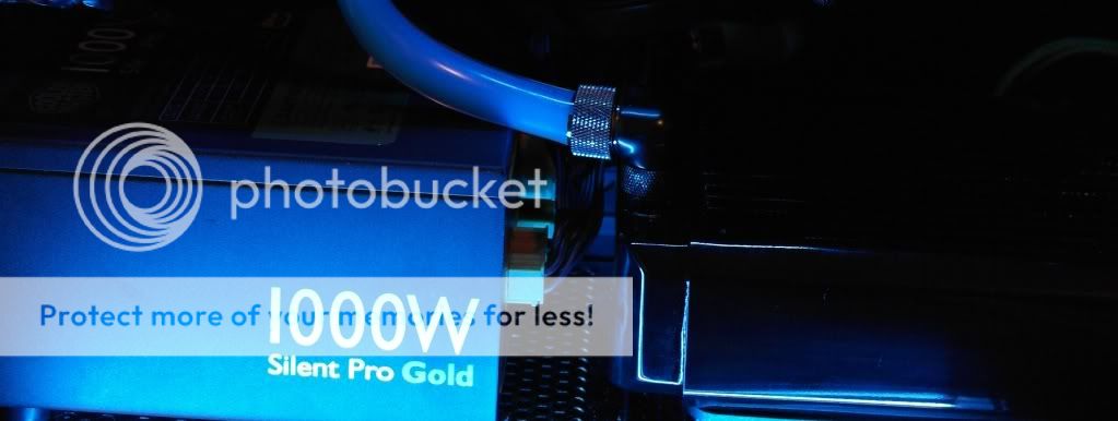

I have a 240 rad and a Corsair AX850 (160mm long) in the bottom of my Switch 810.
There's about a 50mm gap between the PSU and the rad which is just enough room really as the power cables are not particularly flexible.
An AX1200 at 200mm and a 240 rad would not fit in the bottom of this case, there'd be no room to plug the cables into the PSU.
I have a 280 Rad and a 180 PSU with not very much room at all.

I have the ax1200i and the 240 alphacool rad. I just moved the rad towards the front by 35mm and NOW a lot more room for the wiring and my barbs are facing the psu. EASY MOD
