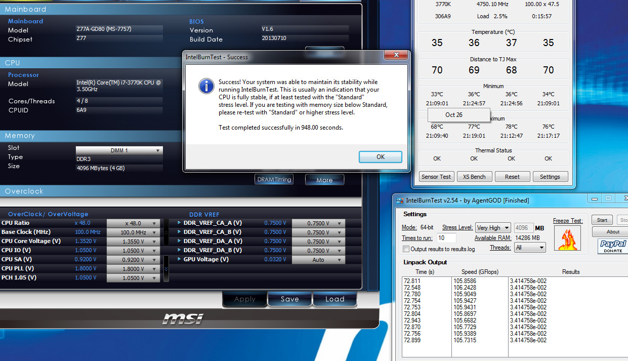

I purchase from overclockers but never looked at the forums so I have come on the say hi.... Hi. Plus I would like some advise on my temps and if there is any minor tweaks in the bios that could bring them down.
thanks :D
4.8 @ 1.3550 vcore running IBT at Very High stress level.
Temps 68-77-78-76
@Bart_Hunt
I am using a XSPC D5 EX360 but with only 2 sp120 quiet's at the moment, only fit this kit 2 days ago, got fans on order.
@smogsy
That is the lowest the Vcore will go. I am fully stable on 4.4 @ 1.14v too but with good cooling I might as well rump it up. I know intel advise max volts of 1.52 for a 3770k so i would imagine anything up to 1.4v will be fine depending on temps. I have seen some stock volts hit up in the 1.3's on some people results.
I moved from a H100i to this kit because I have a R9 290x on the way and would like to add it to the loop. I also have a EX240mm rad sitting on my side which I will fit with the GPU block.
This will take some time to go 10 runs lol I will do one run now and see how much it goes up. Lets see how the SP quiet's handle this lol
Mine is on water. I should do it correctly and take all amb/delta temps as it is warm in this room :/
Delid is the best! I couldnt go more than 4.5 and I was hitting a heat wall. After delid I have gone 5ghz @ 1.5v and temps are 80!
