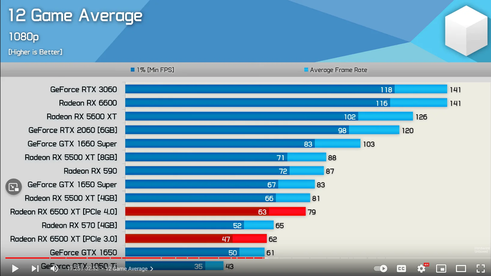

Looking at the performance data generated by this review I suspect that even at PCIe 4.0 x4 there's a significant performance loss for the RX 6500 XT. My estimate would be around 6-10%, which isn't huge, especially in this segment, but it's still performance that could have been easily be achieved for a minimal cost increase. If the cost difference was substantial, everybody would have slimmed down their PCIe interfaces for a long time.
Averaged over our game test suite, we found a 13% loss in performance when switching from the PCIe 4.0 interface to PCIe 3.0. This will happen to you when running the Radeon RX 6500 XT on an Intel platform that's older than Rocket Lake (10th generation and older). On the AMD side PCIe 3.0 is the fastest option when using first generation Zen processors, or when using lower-end motherboards with cheaper chipsets.
I also ran a full batch of tests for the RX 6500 XT operating at PCI-Express 2.0 mode, which is a fairly unlikely scenario. I doubt there's still PCs used for serious gaming with that bus speed. It's still an interesting data point for science. Here the performance loss is another 21% vs PCIe 3.0, and 34% in total when compared against the PCI-Express 4.0 baseline.

Some things are pretty unforgiveable to be fair. Needing a PCI-E 4 board so you're not losing a significant chunk of performance seems a really odd decision.
TPU tests over a dozen games with different PCI-E link speeds:
https://www.techpowerup.com/review/amd-radeon-rx-6500-xt-pci-express-scaling/

Exactly this imo - I'm not sure what people to expect - should people on a budget just not buy a graphics card? or I suppose £200 5 year old ex-mining RX570's are what are recommended?
I appreciate the reviews are comparing apples=apples, but ultra quality settings for everything are never going to be a realistic option for a 4GB card
I'm sure e.g. the AC: Valhalla 60fps 1080P is probably easily achievable by dropping a couple of settings or using the Auto configure options that most games have these days
