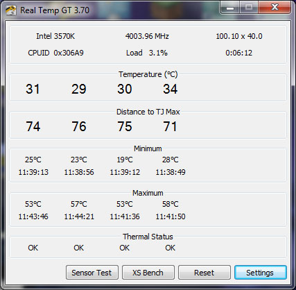

So I delidded my i5, applied some Coollaboratory Liquid Pro to the CPU die and IHS etc My load temps have dropped quite nicely on three of the cores but Real Temp reports one core running approx 12-15c higher than the others. Do you think it is worth remounting the h80i? Or is this common?
Edit : So i reseated the whole lot, I don't think enough was applied. My temps are more even across all 4 cores and lower too.
nice one temps are good aswell for that oc. dont let setter see it :p
