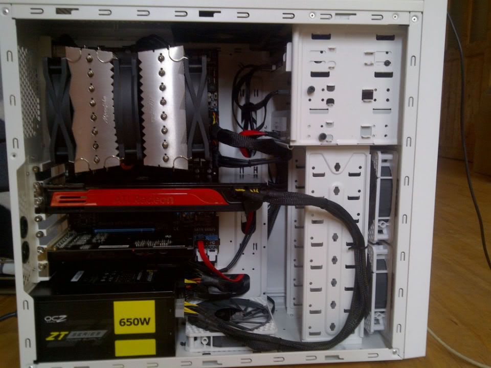

I did a quick load run using Cinebench after installation and @4.5Ghz the K2 kept the cpu temps at around 55-57c.
The stock cooler @3.3Ghz was around 70-75C.
Ambient temps differed by around 2c in each test.

Oh, and doyll, It's about 1-2mm from the side panel lol! The others would never ever have made it
Cheers dude!
