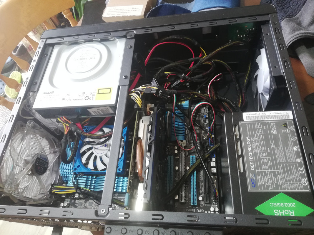

I have an old PC I use under the TV to watch YouTube/netflix etc.
It's based off old/donated parts and is a sandybridge i5 2500k cpu, Asus P87Z motherboard, ram no idea, I think...... A lower end 600w Corsair PSU probably 10 years old, and a Nvidia 960.
Recently it has been just shutting off, so literally just turns off out of the blue then restarts straight away.
Seems to be intermittent but getting more frequent, did it after 5 minutes just now.
Am wondering if it's the PSU but I don't have a spare to swap.
Also wondering if it's worth bothering Vs just replacing the PSU motherboard CPU and ram completely, I'd be looking at new parts but low end, something with an inbuilt CPU/GPU would be perfect as I literally just use it to stream 1080p.
There she is, it's actually an OCZ 600w PSU and that guy is old, 10+ years, heading towards 15 I guess.

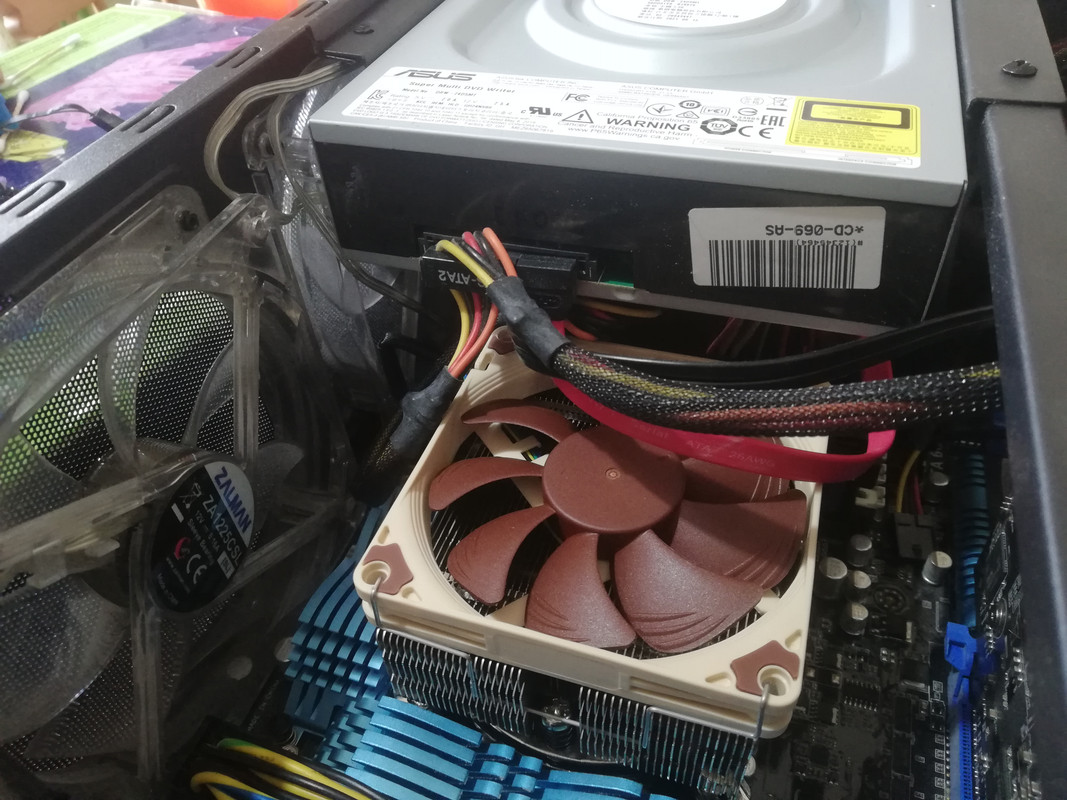

Anyway, when I put the pc together I was a bit over cautious with the size of the CPU cooler, so set my 16 year old son to research a different one as there was actually a bit more space.
He chose a noctua low profile but as you can see from the pictures a fair chunk larger, and actually quite a good fit given those cables coming out the back of the drives.
Anyway got him to change it over, and seems to be working fine now.
I think you should move those cables away from the CPU fan. You don't want them drooping and getting cut.

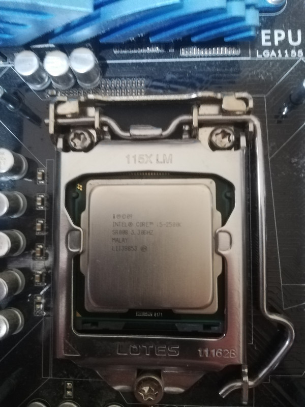

Was working fine for weeks, fired it up last night (after it had been working earlier fine) and nothing, tried to boot for a few seconds, then shuts down, then blips on for a fraction of a second, off for about 30 seconds, then the cycle repeats.
Pulled the case out, took the graphics card out to get to the bios battery, took that out and let it drain for 15 minutes, replaced all, fired back back up working.
Put it back under the TV where it lives, and boom same issue......
Took it out, repeated bios battery out, fires up. Tried retarting it a few times etc, all fine.
Put it back, same problem.
I then though it may be a shorting issue puting the case lid back on etc, but no, put it all back together, including the case, everything, and working fine. I also replaced the bios battery with a new one, just in case. Turned off, restarted etc, completely fine.
So, tried to test something, pulled the PSU cable out for a few minutes, replaced cable, and then boom, problem back.
Repeated the bios battery out, put it all back together, made sure to keep the PSU cable in, put it back under the TV and boom, issue is back.
What the hell?
Ok further update, got it working, I suspect that the time when I tried to put it back under the TV the PSU cable may have come loose. I am relatively confident however, that if the power supply is disconnected, it'll revert back into the bootloop/boot issue, with the only way to fix it being to completly drain the bios.
