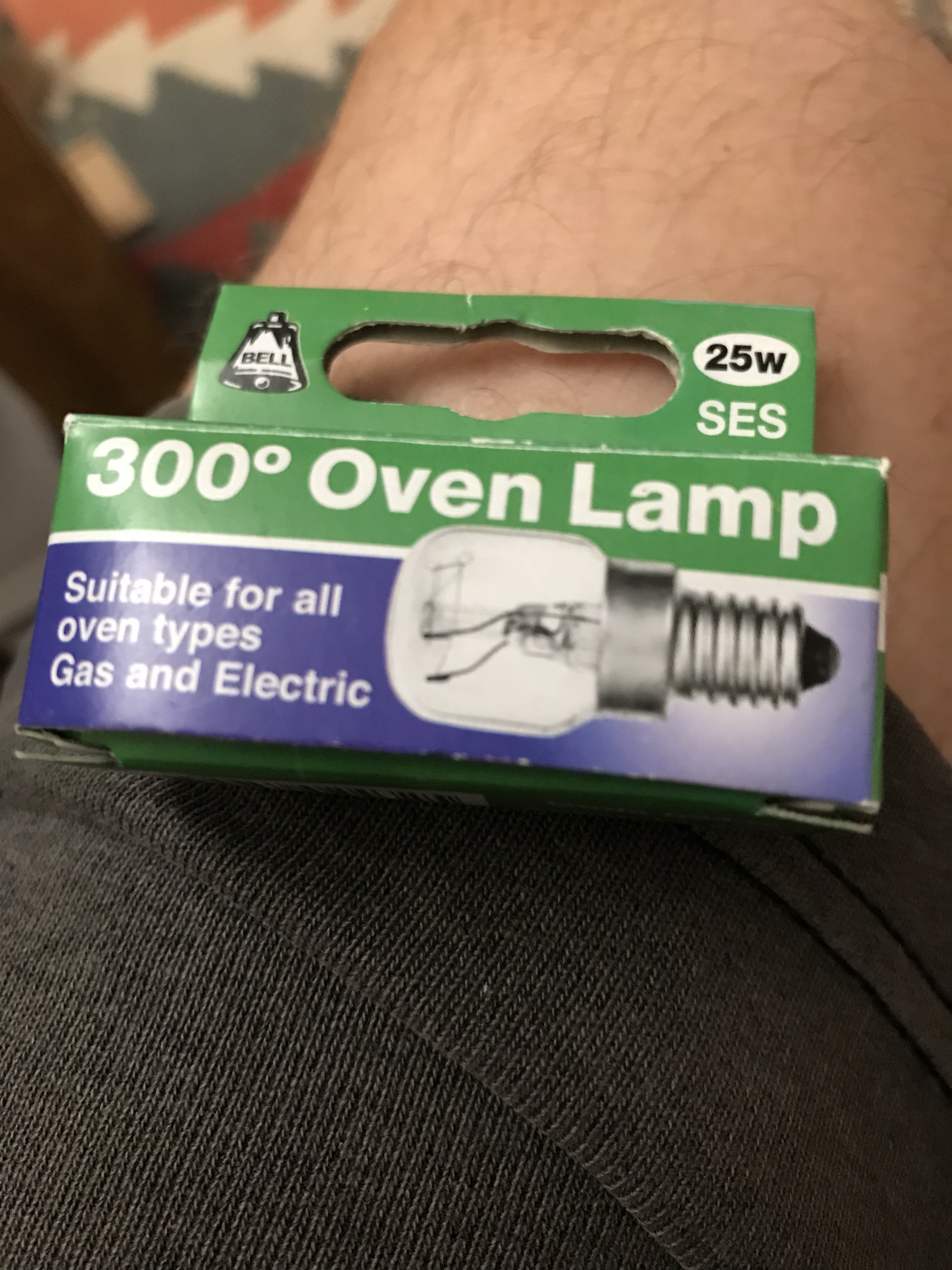

for ses - this is the ses that's been running in my cheaper belling oven for 5 years or so

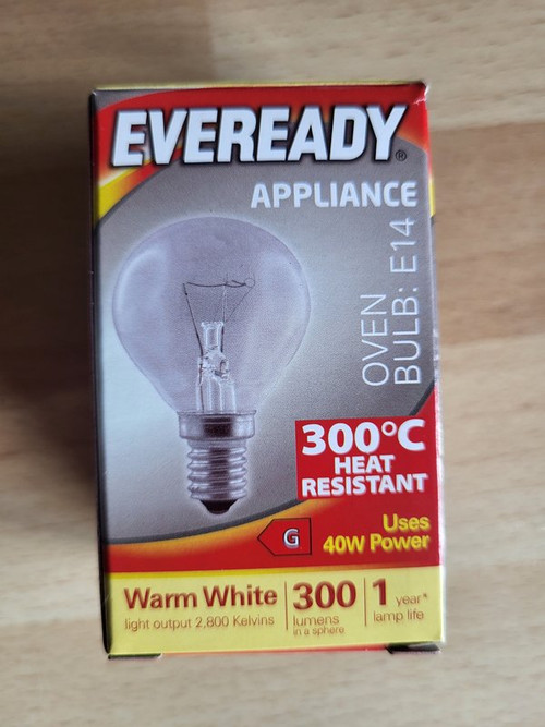

Thanks, yeah it's certainly possible that the terminal connector/s might have come loose and need pushing back on. I'll turn off the power at the fuse box before attempting any cleaning and checking wires. I'll see how it goes with this new bulb first. It might blow at any time in which case I'll try one more without touching it. If that blows I'll have to remove some screws and slide the oven out which will be quite heavy, might need to get a friend in to help. But I'm hoping if this bulb lasts beyond a week I might be ok. The man in the electric wholesale shop said that some, like the one I showed him that had blown, look identical to oven bulbs but aren't designed for ovens as they don't have a protective coating. That said, I'm pretty sure the ones I got from builders depot were oven bulbs. But anyway, maybe this Eveready one will be better, fingers crossed! When I screwed it in last night I backed it off a little so it wasn't too tight.

I bought this today. No idea if it'll last or not, we'll see.
Just a follow up, this bulb (which I bought in July from an electric wholesaler shop instead of builders depot) has been flawless and has kept going for the last 3 months. It'll probably blow now I've said that!
