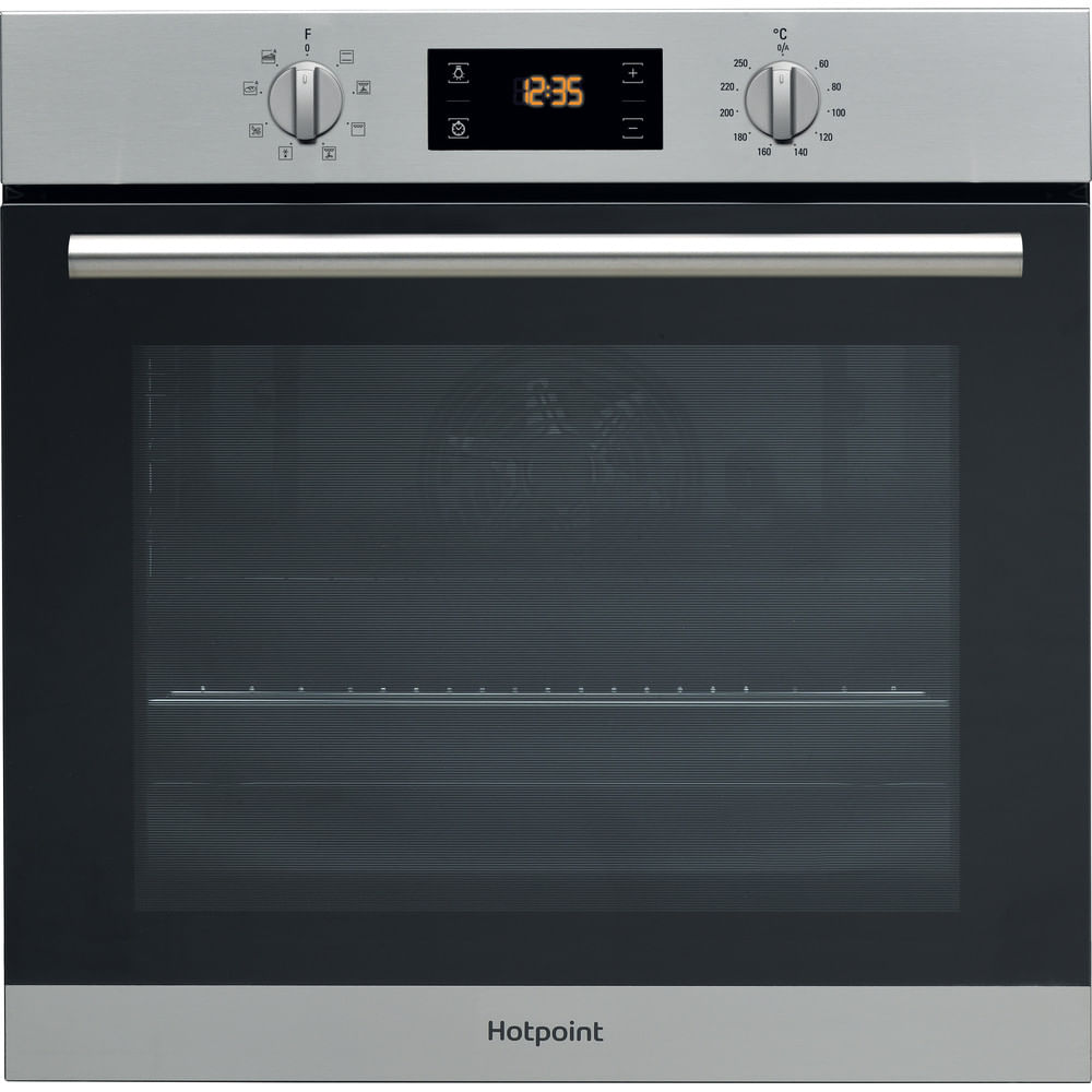

Two ovens I'm looking at are:
and
Reason I'm looking at these two is because a friend works for them and can currently get either of these as a brand new but with minor cosmetic defects, so can get them for around £130 which is decent.
