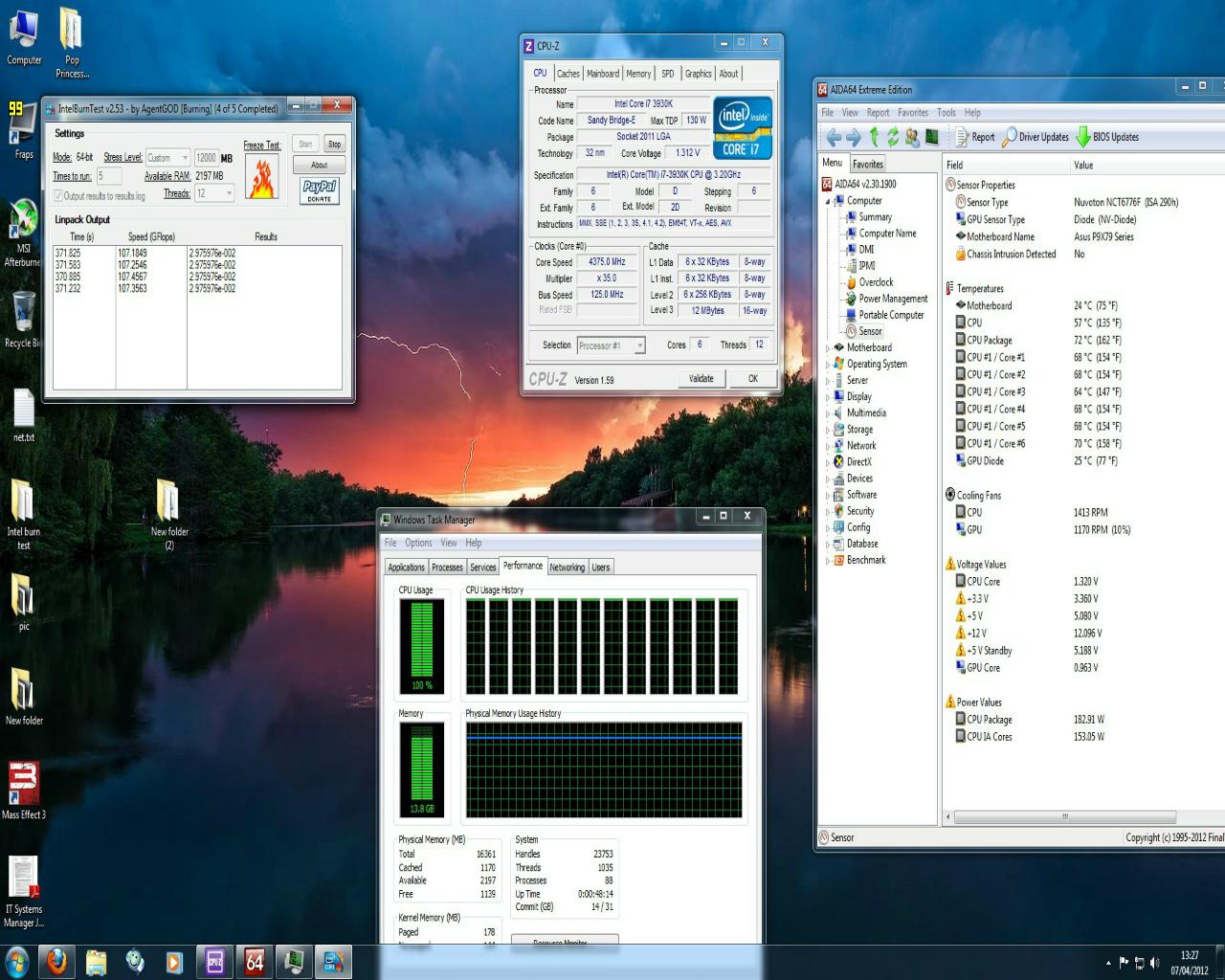

ok so far ive got it clocked at 4.3 (in cpuz it says 4.375) and 1.290 vcore im using Intel burn test with custom settings testing 12gb of my 16gb ram (everytime i selected maxium it says cannot test more memory than i have so i set it to 12gb) 12 threads and 5 passes will that be ok to test the stability and if its stable ill try bit lower vcore does this sound ok?
here is a screen shot during the IBT
aplogies if the image isnt that clear ive resized it.
Thanks

well IBT seemed to stress mine fully as you can see from the task manager and i just chose the strap cos that was the first thing i tried and thought 4.3 was a good start it slightly overclocks my ram from 1600mhz to 1666mhz as well not sure wheather there is an advantage or not i may try just setting the multiplyer how long did you test with prime95 for i did 5 passes with IBT
Mine shows 100% usage with IBT as well but it still seems to be underperforming, your Gigaflops is a little low I think so yours might be too.
Coretemp gives you a dynamic power reading and for some reason it won't go above 142W with IBT.

ok ive just taken the strap back to normal and put in a multiplyer of 44 left the vcore at 1.290 (although it shows slightly higher in cpuz)
here is how it looks so far
