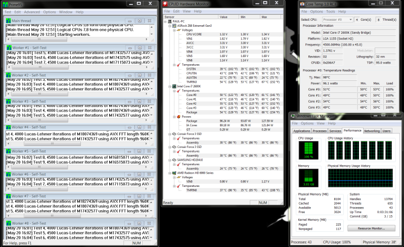

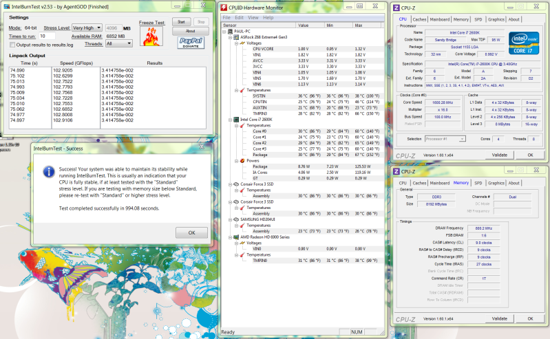

I just ran IBT very high settings on 4.5ghz @1.29v 10runs with a pass and am now running Prime95 Blend v277, it`s been running for about 40mins now with temps maxing at 65c.
I will post a screen shot when primes done.
looking good to me.
and IBT
Has anyone got 4.5 with lower volts or should i be happy and stick with this?
