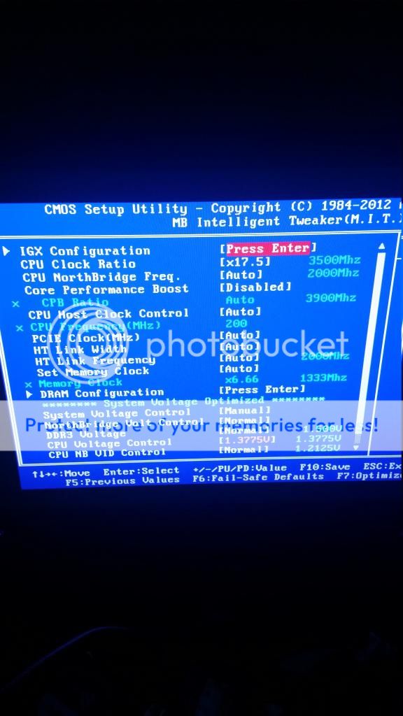

hi again... i thought i had successfully overclocked my fx6100 via amd overdrive however turned the pc on today and it reset back to origonal so i have decided to do as advised and learn bios...
i have set it to run @4.2mhz with a voltage of 1.3775v as seen in photo below. however when i run stress test.. the voltage is stock and mhz throttles back to 3.1mhz have i changed something im not supposed to from my settings below????

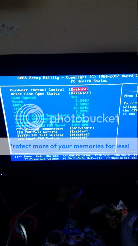

It's because you've got hardware thermal control enabled however you've given no indication of why you've set the CPU voltage as such, what kind of stress test you're running and what core/voltage regulator temperatures you are hitting.
lower the voltage as low as it'll go and use the AMD overdrive stress test as if you're running Prime it'll cripple your CPU unless you're under water. Prime can make AMD FX CPUs throttle at stock settings.

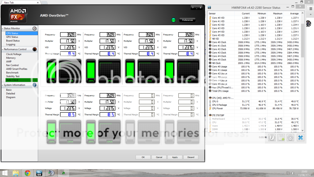

i am using amd overdrive for the stress test. i set my voltage that high as it was what i set it to last night on overdrive but for some reason it reset its self to stock again today.
as for temps it hit a max of 51c after 25 mins of stress test. i will go in bios adjust what you have stated and lower my voltage and go from there

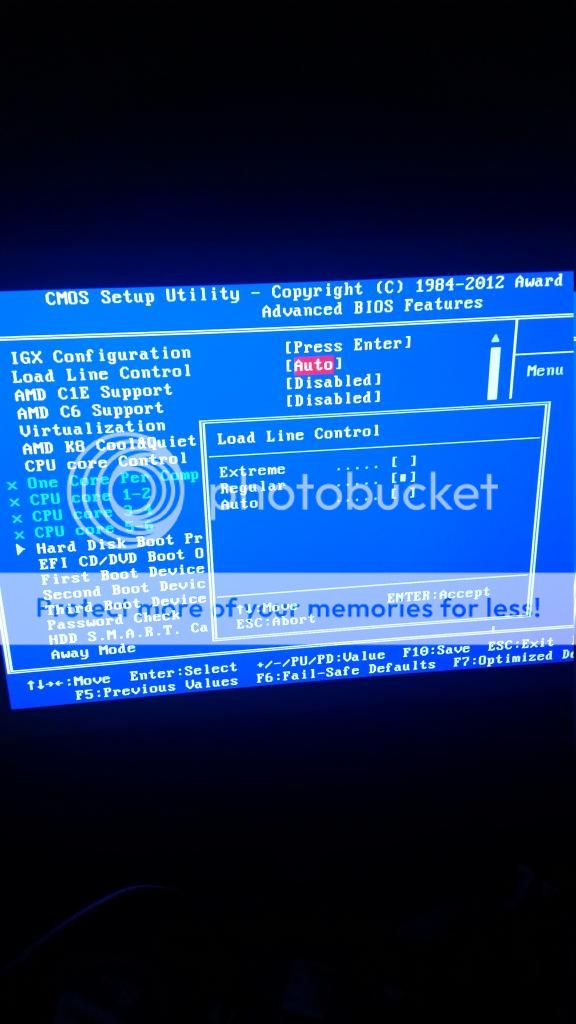

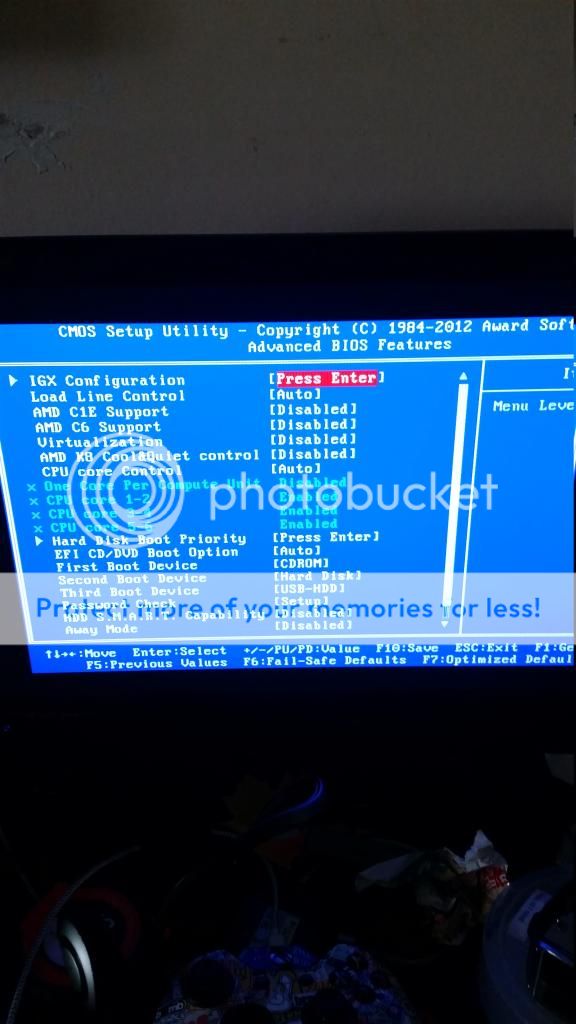

The reason he is crashing from recently overclocking in the bios is that he hasn't got any llc on. Simply the vdroop is bringing him down below 1.325v.
In the bios he needs to go to advanced bios features and uner the load line calibration change it from auto to extreme,. this will add +.40 v-core.
However he must then change the offset v-core to 1.335v.

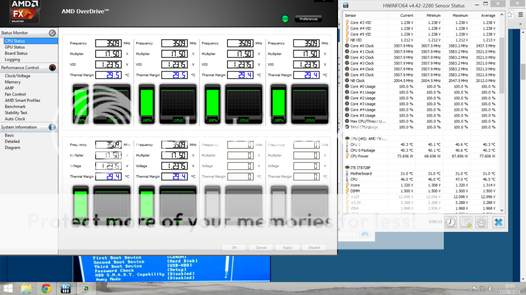

let's refer to your bios settings pictures above.
The 4ghz config with a 20x multi, turn it down to 35x so the cpu will be 3.5ghz
Now leave the voltage at 1.3775v

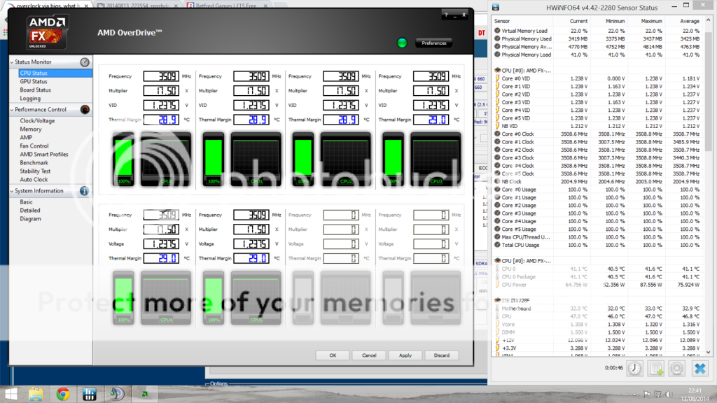

boot into windows and with stability testing like you did before tell show me the voltage the chip is running at when under load.
I need to work out the correct llc and voltage for you then we can enable lcc and get your voltage right.
below is as you have just said... i have not adjusted the other settings you mentioned before load line to extreame ect...
