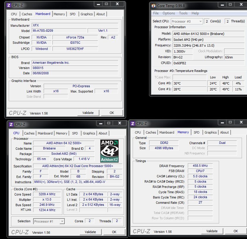

i was running just over 3.0 on air FSB set to 230
with everything else on auto
i did have memory on T2 again everything on auto.
i found that i couldnt go much higher as temps became problematic
during the cold spell i was able to get 3.15 was -17 outside mind you and pc is close to the window

yeah was a bit unstable after a while, around 45 -60mins of prime, you could hardly touch the northbridge. however since sticking a fan over it theres been no problem and its on pretty much 24/7.
looks like i pretty lucky
yeah but i never got the auto oc to work and at the time i wasnt really bothered.
started to do it manually and got around 2.9 but temps were the killer after that your talking seeing high 30s, low 40s for idle :eek:
