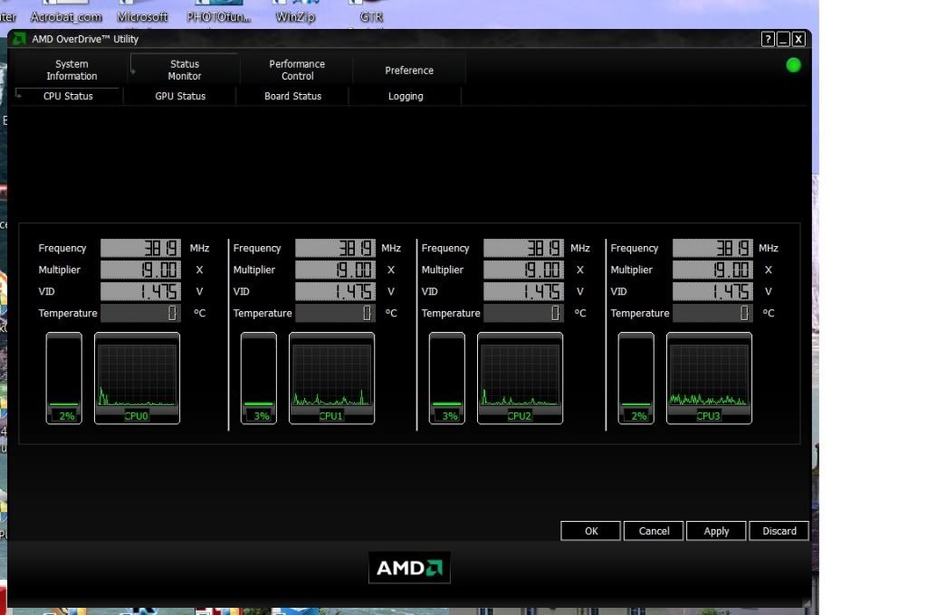

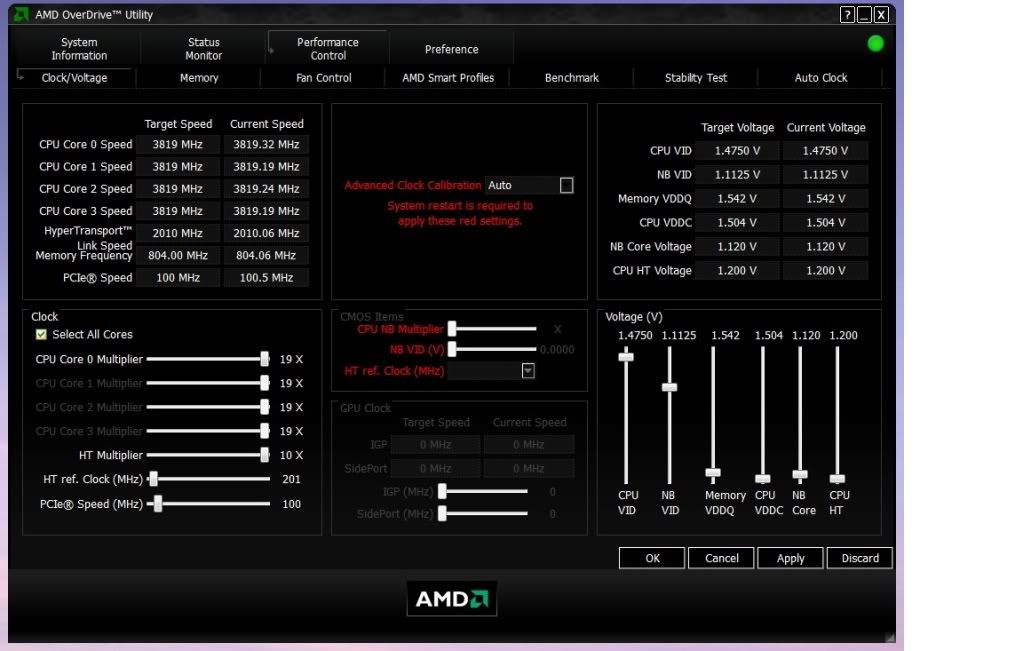

Thanks guys, messed around a bit more and have now got to this stage with no fails or faults after running Prime95 for two and a half hours and MemTest for an hour.
Quite pleased with myself as 18 months ago I knew nothing about building or overclocking PC's. Not bad for someone into their second half century.
