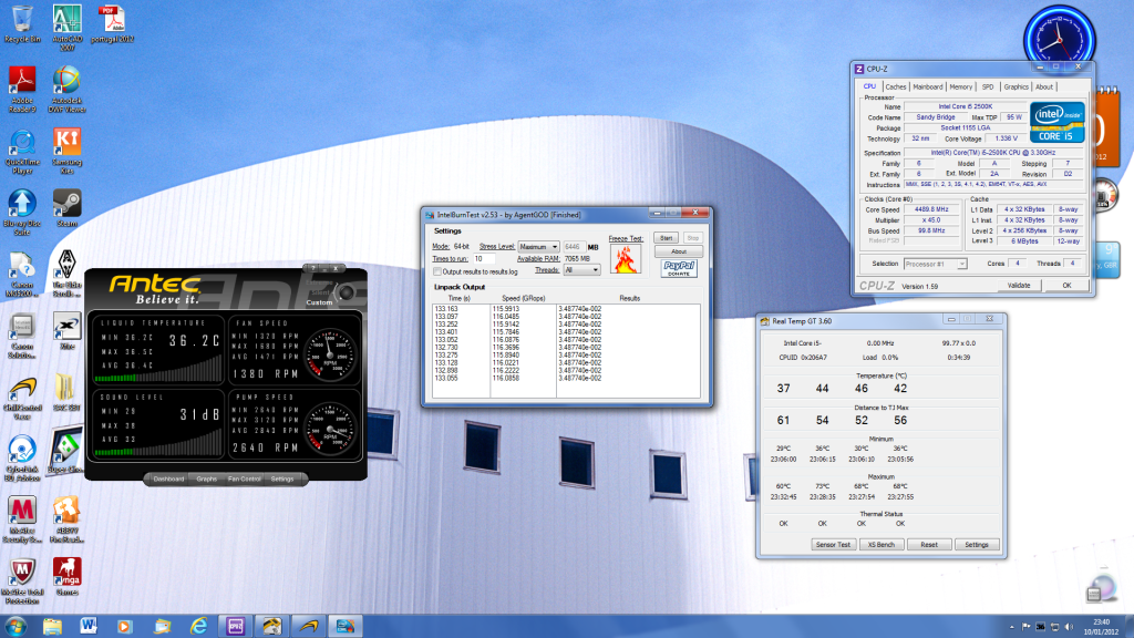

tried at putting it to 45 with auto vcore, and went passed first bit just before windows loads the screen goes black with a small white line in the top left of the screen
is this ok?
if u cant see the pic
4.5ghz, 1.336vcore -cpuz
intelburn test on max
max temps across cores: 60, 73, 68, 68
idle temps across cores: 29, 36, 30, 36
That looks OK - temps could be a touch better but nothing to worry overly about. IBT is a really good initial indicator of stability - once you're stable with that, try running Prime for 12 hours or so (or as long as you can). Very little will load your CPU like IBT does - expect around 10C lower temps when Priming versus IBT.
