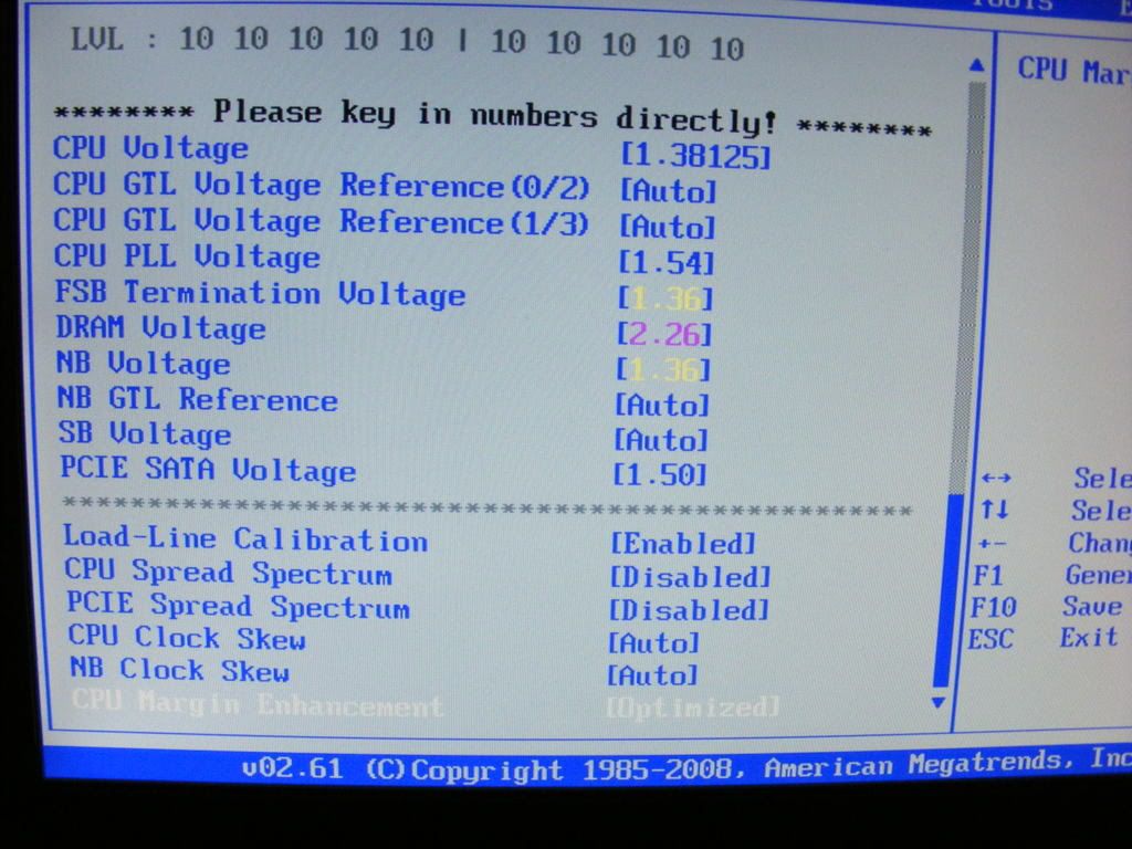

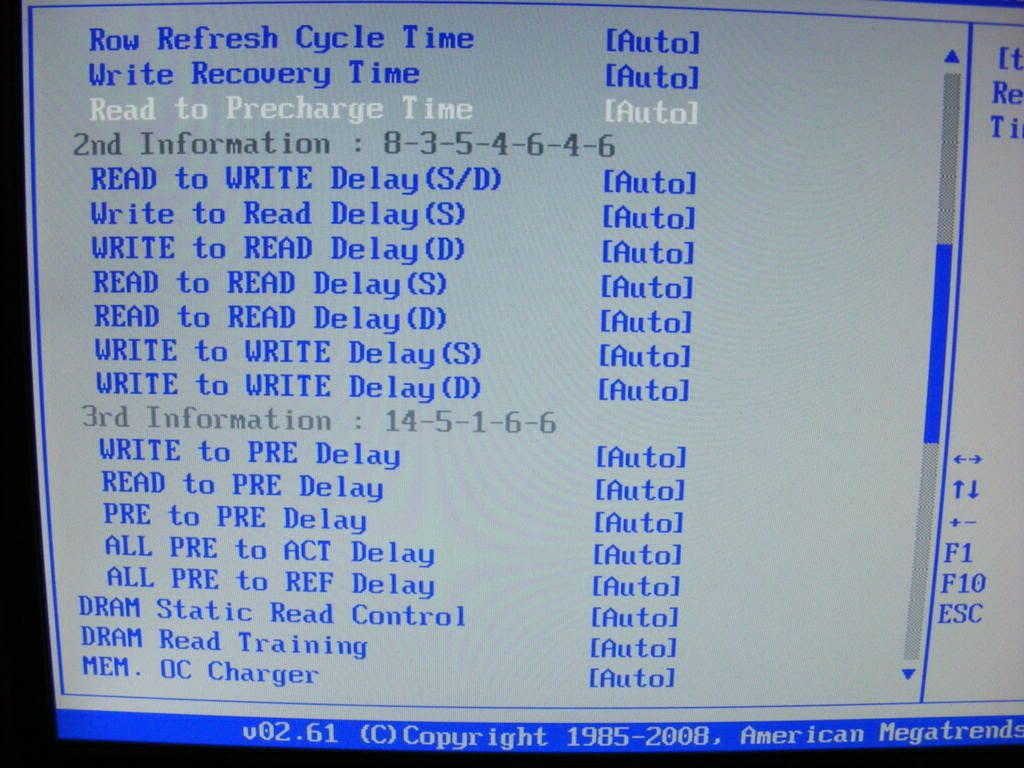

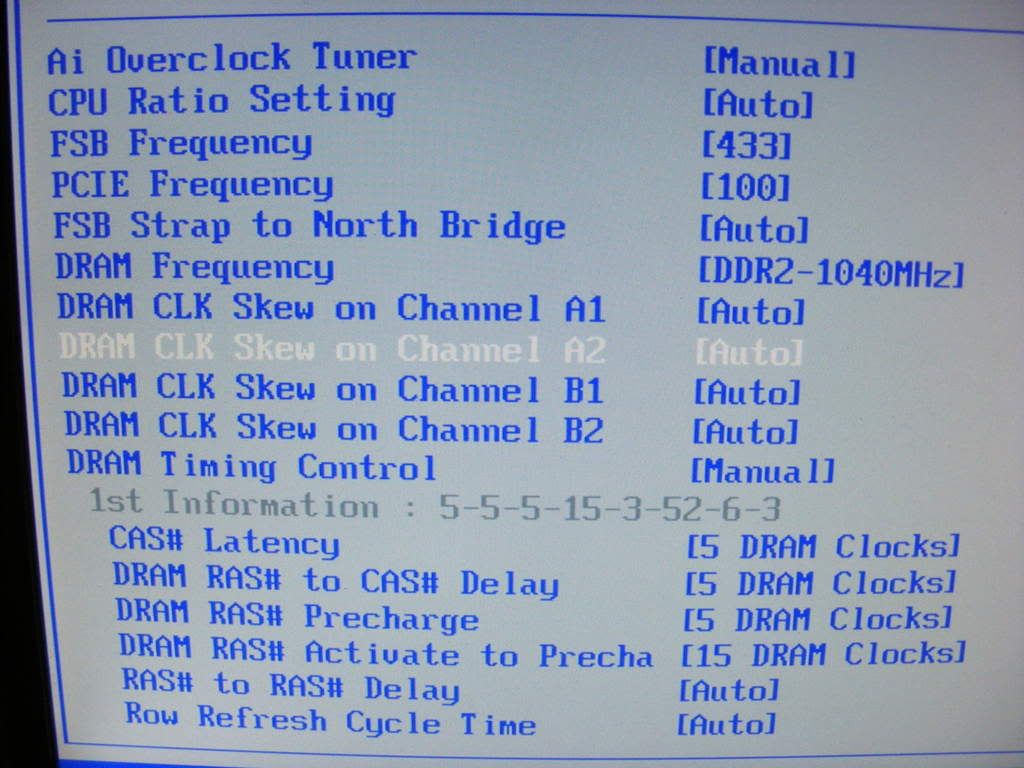

Here are my BIOS settings

Any ideas what settings I should change to get it more stable? I'm assuming, because its Blend and Large FFT which are failing its something to do with the ram?

RAM settings are ok.What real vcore you have got in Windows?
You should disable C1E and EIST in BIOS.
You can try up the vcore - max safe is 1.36-38v (real - Cpuz) - I wouldn't go higher for 24/7

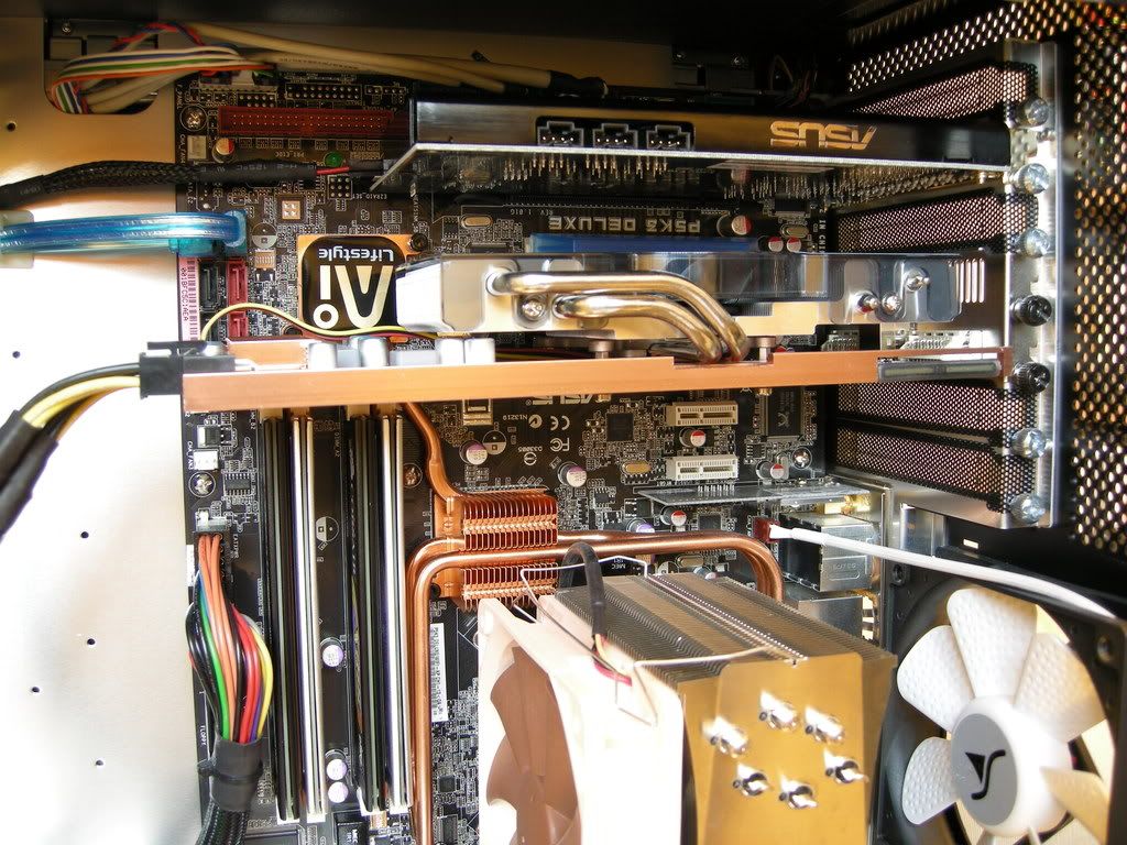

The only thing i did want to mention was that the two noctua fans your using on your heatsink arn't actually very good for what your using them for... they're excellent at pushing air around the case, but they have crap static pressure, which means they suffer when up against radiators/heatsinks etc.
Just thought i'd mention it, maybe swapping your fans would give you an extra degree or two :)

If they're the NF-P12 type fans then it is designed for maximum static pressure next to radiator fins.
I have only one on mine, but it is a thermalright ultra 120, and it is keeping myine nice and chilled.
