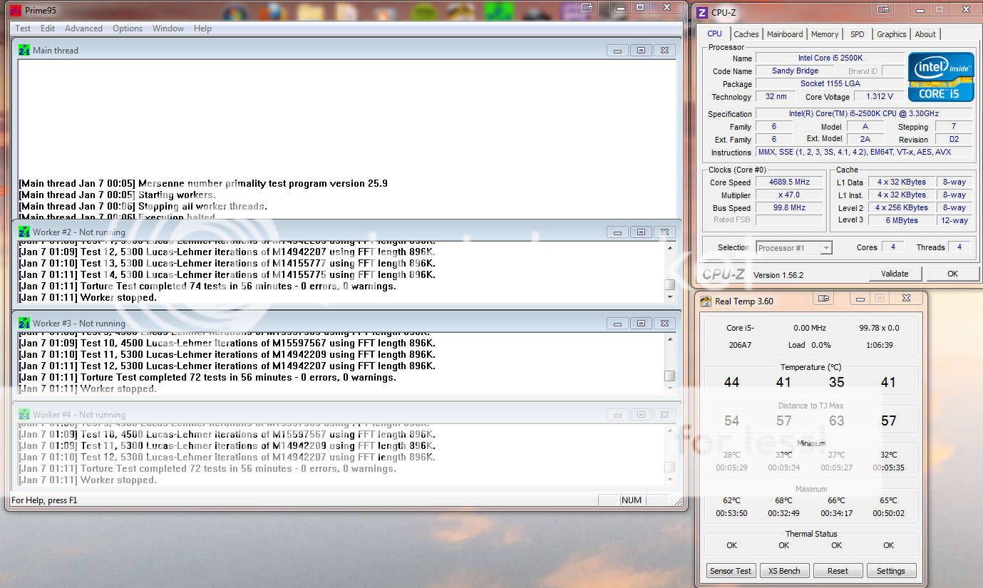

I am posting this as prime95 is running. Don't think I could do that when i ran an older version of prime95, on my Q6600.
Prime95
I have completed a six hour prime95 with no errors. Despite is saying 3.4 it is 4.6 like explained in my previous post.

Well as I posted above, I used prime95 to test my 4.6 overclock but because of the buggy bios I have, it still shows 3,4.

Well I have just updated my bios to V1.7. It now shows my overclock correctly. So it was a buggy bios that was causing that.
The saved OC i did in the bios can not be used with bios v1.7. So had to input all again. Some things seem slightly different. My CPU temp in the bios seems to be different from in windows. See my picture and for the correct CPU frequency.
