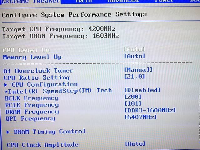

The lowest I can set my QPI is 6407Mhz (summat like that) after increasing my BCLK to 200. I don't know what's classed at high for my chipset (p55)

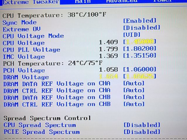

MMMMM I fount out my bios was out of date by about 8 months ^_^.

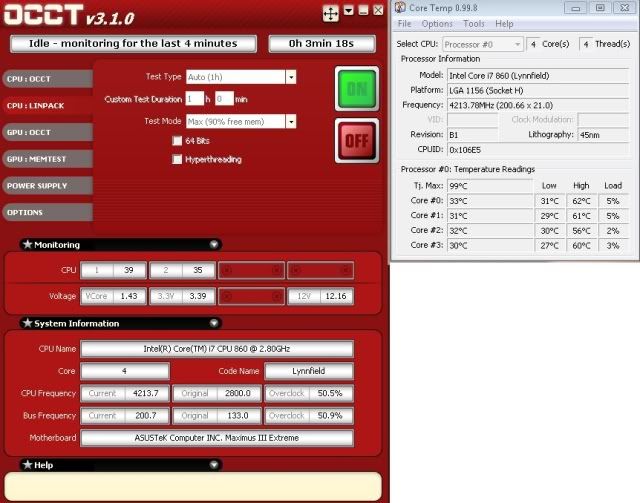

I've upgrading my BIOS to the latest version. I ran my system at 4.2Ghz @ 200 * 21 for an hour using OCCT (This was without HT and power saving features are turned off)

I'm going to be priming my system all day tomorrow, see if I run into any problems.
Seems okay so-far (I hope)
Looking good. Been priming for 12 hours now with them settings. The max temperature is at 58 degrees for a quad core 4.2ghz clock 200*21
