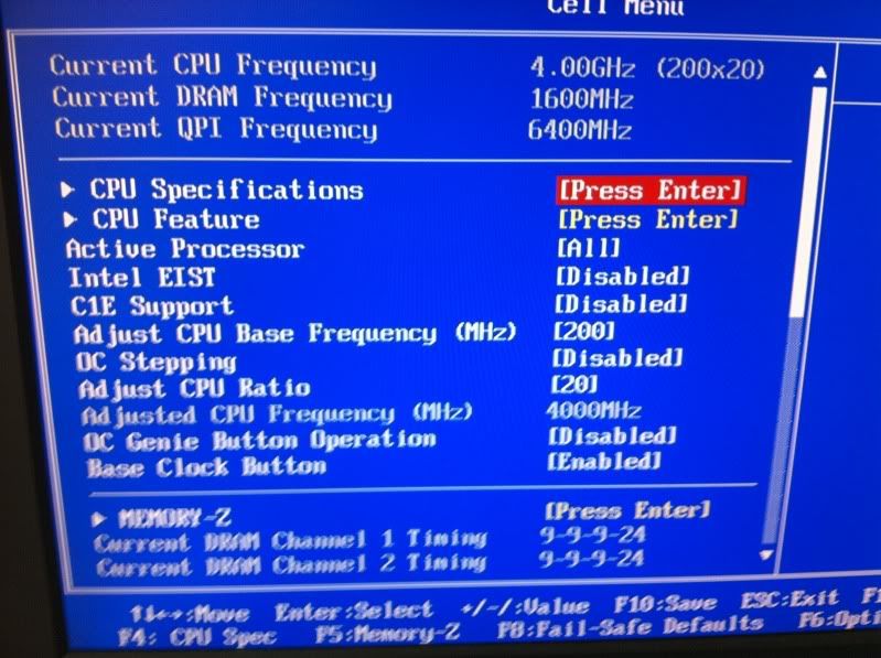

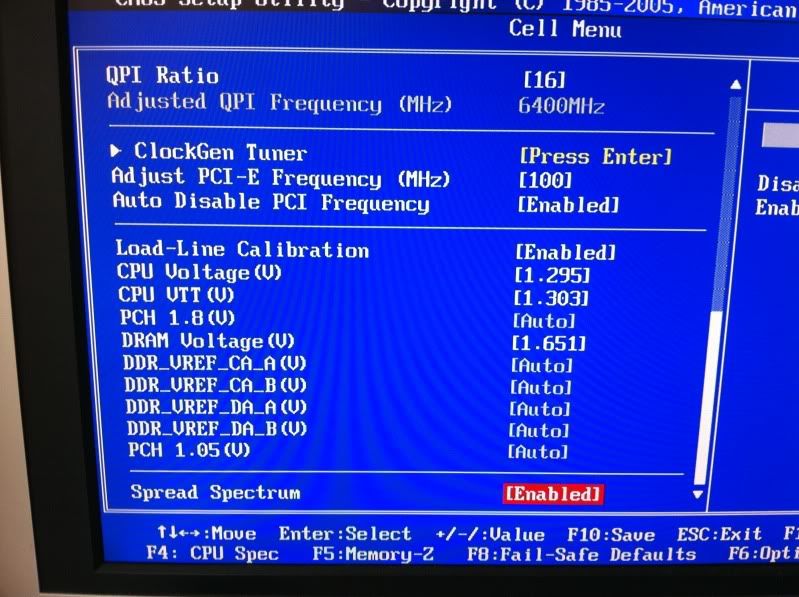

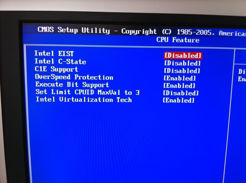

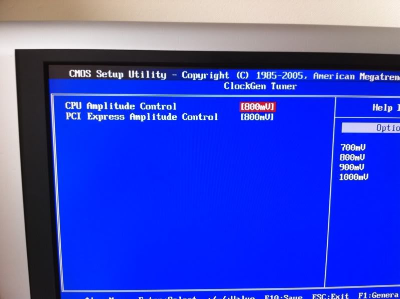

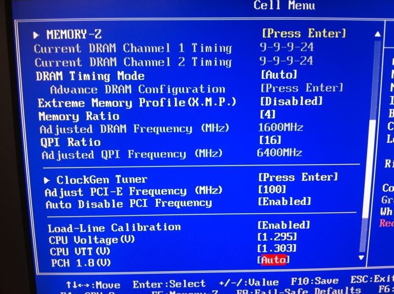

hello,
I've taken some picture of my bios setting, i was hoping some of you overclock Pr0's out there could tell me i've got it set up rite.
here are the picture:
please let me know what you think.
thanks
Could also mean your memory is unstable (depending which test you have run) as changing the cpu frequency also changes ram frequency. If this is the case you can change your multi from 20 and use a lower frequency for a higher clock.
ok thank you. i turned off spread spectrum off as i found out that is meant to be switched off!...
what things would you change by looking at my screen shots i took.
