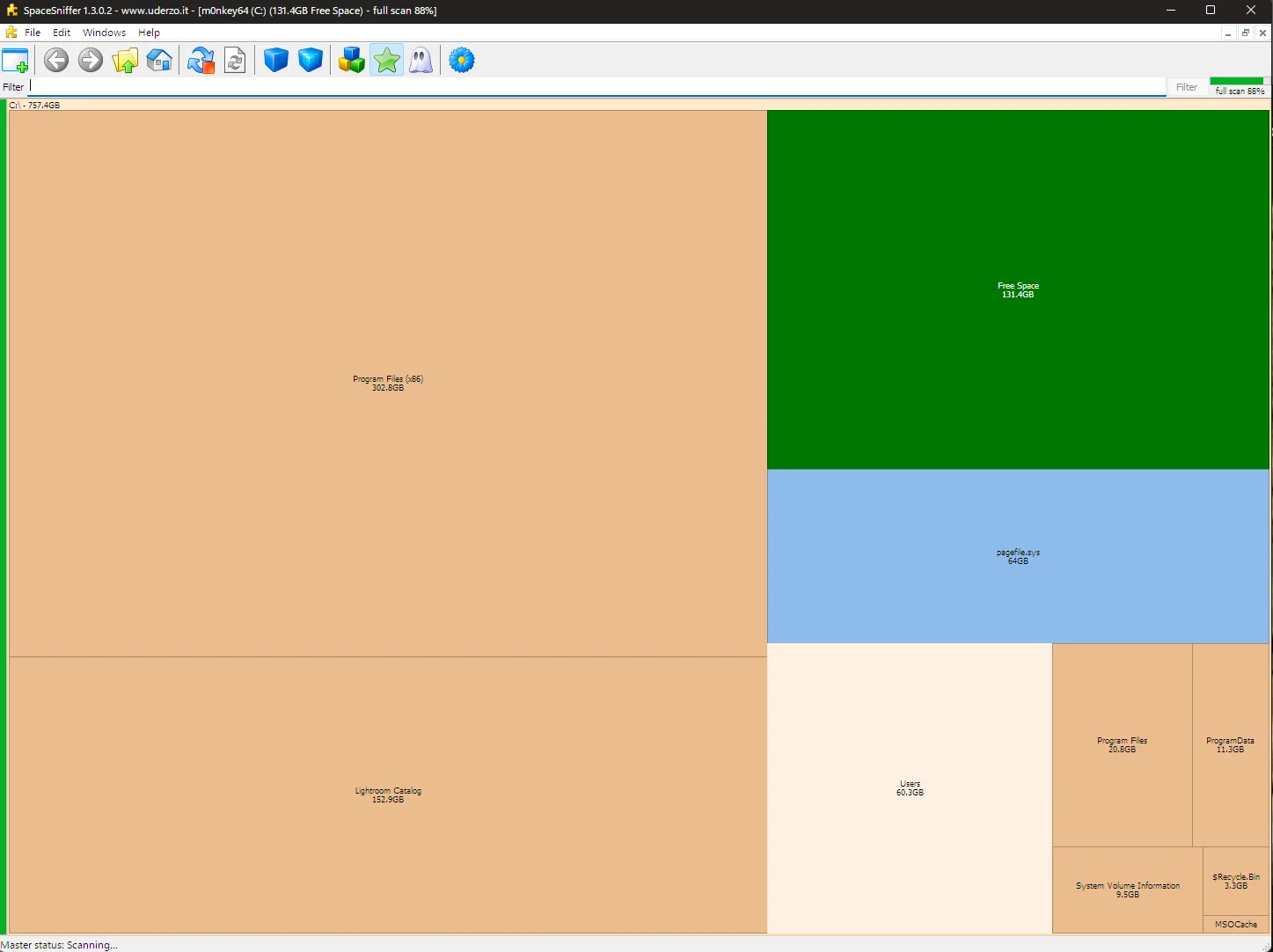

Just keep in mind that Windows will expand it to your RAM size, so if your OS drive is fairly small, you may find space an issue. I have 64GB RAM for example, my pagefile is:

My setup is set to system managed, I have 64GB RAM and my pagefile is exactly 64GB.
