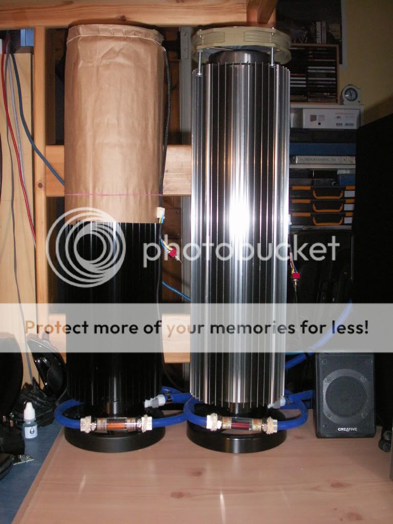

Yes... here's my passively cooled water tower for my 2500k on the right, the one on the left is for my 570. The fans on top are normally off, I just use them when playing games. I didn't add one to the cpu tower until I overclocked to 4.4 it just didn't need it before at stock speeds even on prime.
I realise this isn't quite the same thing at all as that case, but once the water has heated up it's passively cooled like the case so I feel it is at least somewhat relevant :p
