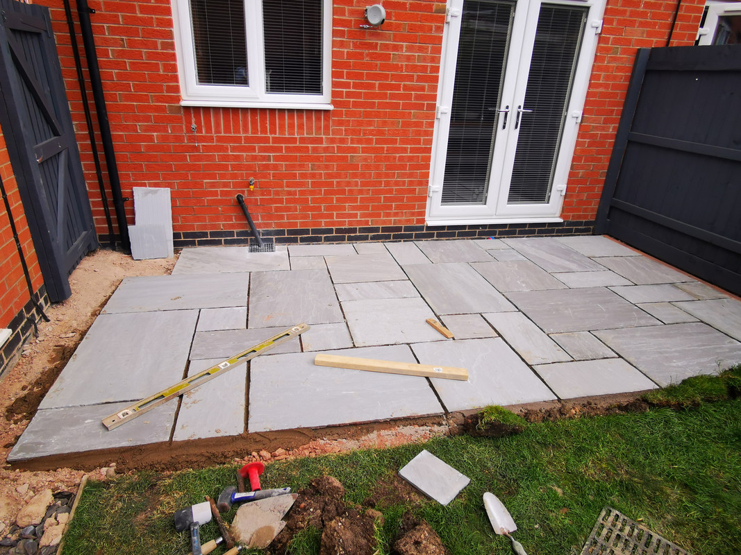

at gate
just start from the slab thats cut around the pipe. i would cut a 300x300mm slab first and then work back from there, looking at pic, a 600mmx600mm could go next with the cut for the drain, i think you would struggle to cut a U shape from the middle of a 900 slab.
just try and have any cuts near the edge of a slab if possible (ignore this bit if your job is an L shape)
Is the gate area at the side of your house? in other words you have a patio and then a side path? like a L shape?
if so we will usually work from the patio to the path, we would start a the corner of the L so you dont have cuts along the house edge of the patio and path

at gate
Here's a better pic gate leads to our drive.
Also hoping I don't need to buy a bigger angle grinder I've a bosch 115mm Pro with a few diamond discs
Thought I'd post an update spent the last 2 days doing this happy with it although a few of the smaller slabs seem to throw out the joints which is annoying as some of the joints are slightly wider.
We left a small gap round the edge for slate, going to run a small bit up past the garage door to the post.
We also followed a pattern but got to the end and improvised on the last row, just 4 cuts to do tomorrow.
Got quite a few slabs left was tempted to curve the patio out into the grass in front of the doors more.
Hopefully it's ok first time doing a patio
Looks good! I've got exactly the same looking slabs and I think very similar if not identical pattern on mine which was here when I moved in. Only issue I have is all the mortar has fallen to bits and when walking bare feet I am often stepping on bits of it! Mine is quite large so a big job to re point. CBA atm.
Looking good op. yeah the small ones are slighly larger and do force the joints slightly wider, and you done the U cut around the gully, well done

Thanks
Almost finished
Decided to extend it out more with what we had leftover.
