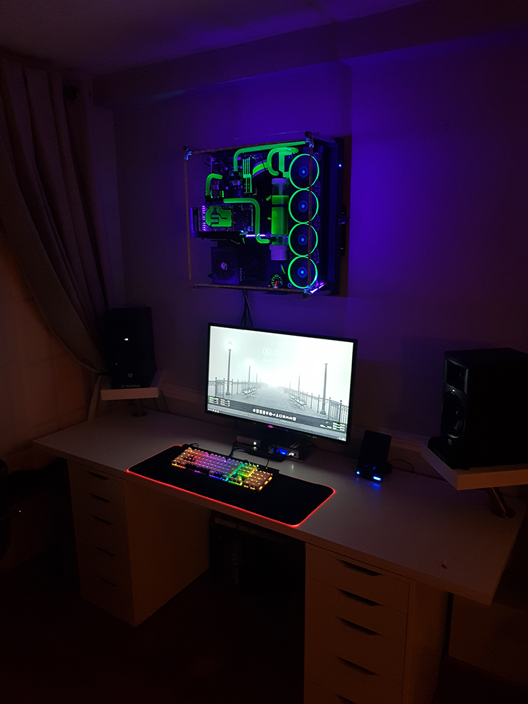

I have a my P5 wall mounted above my desk. I know its easier as it has a VESA mount built in. I used anchor bolts and its probably overkill. I could sit on top of the P5 and it wouldnt budge :)
