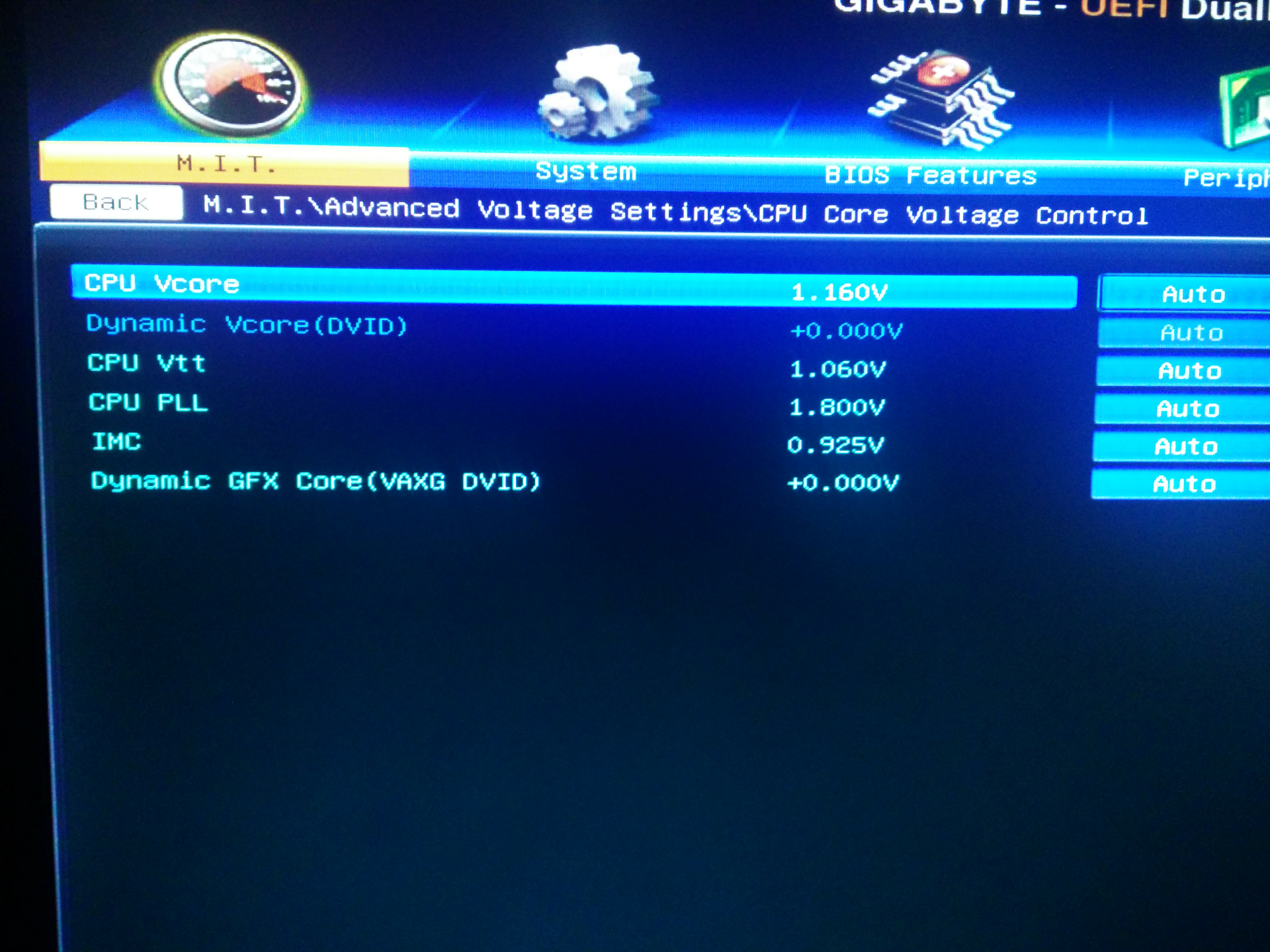

What are the exact messages you are getting on the blue screens? When you installed the new CPU did you check the voltage was set correctly in the BIOS? Is it running at stock voltage/multiplier speed? I would check this as well as run memory tests and scan your hard disk for errors as a number of different things could be causing this..

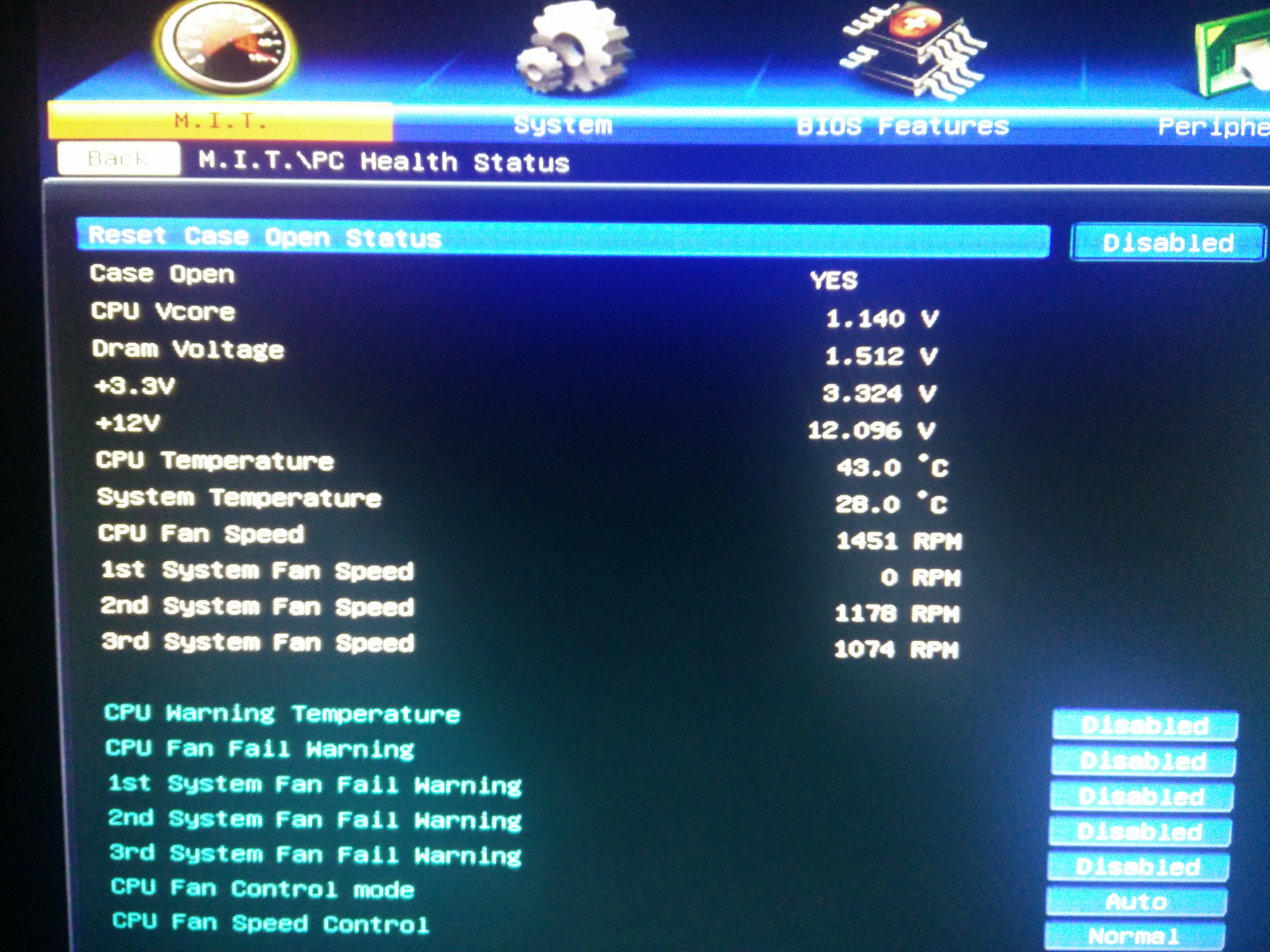

I wasn't able to copy down the full message in time unfortunately and the last couple of times it's just been these freezes. I know the message said hardware failure. I didn't check the voltage was set but i've checked it now and some info is provided in the image links below. What kind of memory tests do you mean and how would i go about running them? I reinstalled windows earlier today as it wasn't too much hassle as I have very little on the computer at the moment. I didn't erase everything on my drives though, do you think that might be necessary?
https://i.gyazo.com/9184a77f4fdce639beb8b0871b695c29.png
https://i.gyazo.com/2ec43c9f1eacf10a73da4d8e4945d683.png
