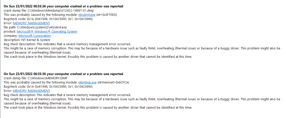

Little update, been away for a few days, left pc on as i needed access to it while i was away. Came back and it was off, turns out it bluescreened.
These are pretty unspecific but from googling the ntkrnlmp.exe one is usually GPU / GPU driver issue.... faulty card? I can't see drivers causing PC to reset.

The pictures you posted suggests to me the problem is the system RAM. Do you have any spare old RAM you can swap in temporarily?

So update. Had one blue screen and one power cut since swapping out gpu. Ram memtest and seems one of the sticks is faulty. Have identified which and running a memtest on the other 3 to check it's just the one. Confirmed as well that it's not the slot on the motherboard 100% the stick. I suspect my gpu RMA will be rejected :cry::cry:
