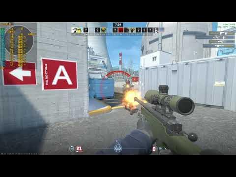

So i was able to show stats in game using afterburner and riva turner but i dont know how to calculate the average CPU/GPU percentage. I saw a formula saying "CPU Utilization = (Total Time Spent on Non-Idle Tasks / Total Time) x 100" but i really dont get it since its about in game. In case that will be enough i will now make an improvised test focusing on GPU then CPU trying to get some accurate numbers.
- GPU: on deathmatch between 33 and 45%, in match average between 50 and 71%, low peek 40 up peek 86, around 60°C.
- CPU: pretty much stable at 35 - 38%, low peek 32 up peek 44, around 70°C, 4006 MHz. (didn't include the CPU 1,2,3,4,5,... info)
By being able to see my accurate fps i can make an update: in match it ranges between 130 and 210 often getting back to 150/190 from the two, lows at 100+ and ups at 220, but in deathmatch i fall down to 80 fps multiple times a session and the average falls down to 110/150.
If you need a proper test just tell me how and i will do it, i could even make a video capture and post it on youtube if you need with that riva turner info on.
That's a bit confusing, because it suggests your whole system is being throttled, but I suspect it is because CS2 doesn't use all the cores, so I'm still of the belief that you have primarily a CPU bottleneck.
Is there any change in the % usage of the CPU/GPU while you get these frame drops?

I made a video capture on a deathmatch session and saw the CPU % go up and also the GPU % but randomly and not everytime so its confusing to me as i have no sense of normality in all this.
I made a youtube channel and uploaded it so you can check it in details, also timestamped when the fps dropped to 100 and lower (67) so you dont waste time waiting for it.
Here is the name of the channel: TESTFORTETRAS (last time i put a link it got cancelled so you can either write it in youtube search bar or in URL put /@TESTFORTETRAS after youtube.com)

I'm terrible at watching these kind of videos, so I'm afraid it doesn't tell me much, but hopefully someone else will watch it and let you know their opinion on what it says about the bottleneck.

I watched the first few minutes and scrubbed through the rest. No CPU core is hitting 100%; indeed the highest I saw was about 80%. Your GPU is barely breaking 40%. Your system has plenty of performance to spare.
I did note that CPU temperatures were locked in the mid 70s. So I wonder if your PC is thermal throttling. Your first step should be checking the BIOS for that temperature limit - I'll let a BIOS expert advise you on that. And after that you should look into a decent CPU cooler. Something like a Thermalright Assassin - if it will fit in your case.
BTW have you updated the BIOS? Latest is F18 and I see that BIOSes prior to F17 have some issues with RTX 3060 cards.

Here's the link:

4070 is a good shout, I was getting around 465fps on most maps even with a 5700x at 1440p low in linux mint, haven't tested in windows as that machine lives under the tv now.
But for ref with a 5800X3D...
