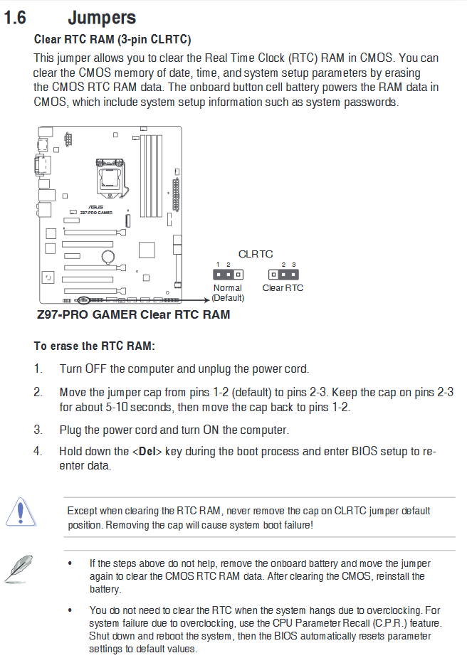

If no joy, then reset CMOS completely by shorting the appropriate pins on the board. See in spoiler the relevant section with detailed info on how to do this for your motherboard:

Page 1-21 in the manual explains how to clear RTC Ram) if you are unsure. **Edit Danny75 has put this page up on his response**

I cleared the cmos and it was the same thing where it just went to bios but now I tried booting from USB with windows on it and used the windows start up repair, it said it failed to repair but I rebooted and I got into windows! I don't know what the repair actually does but I guess it worked.
