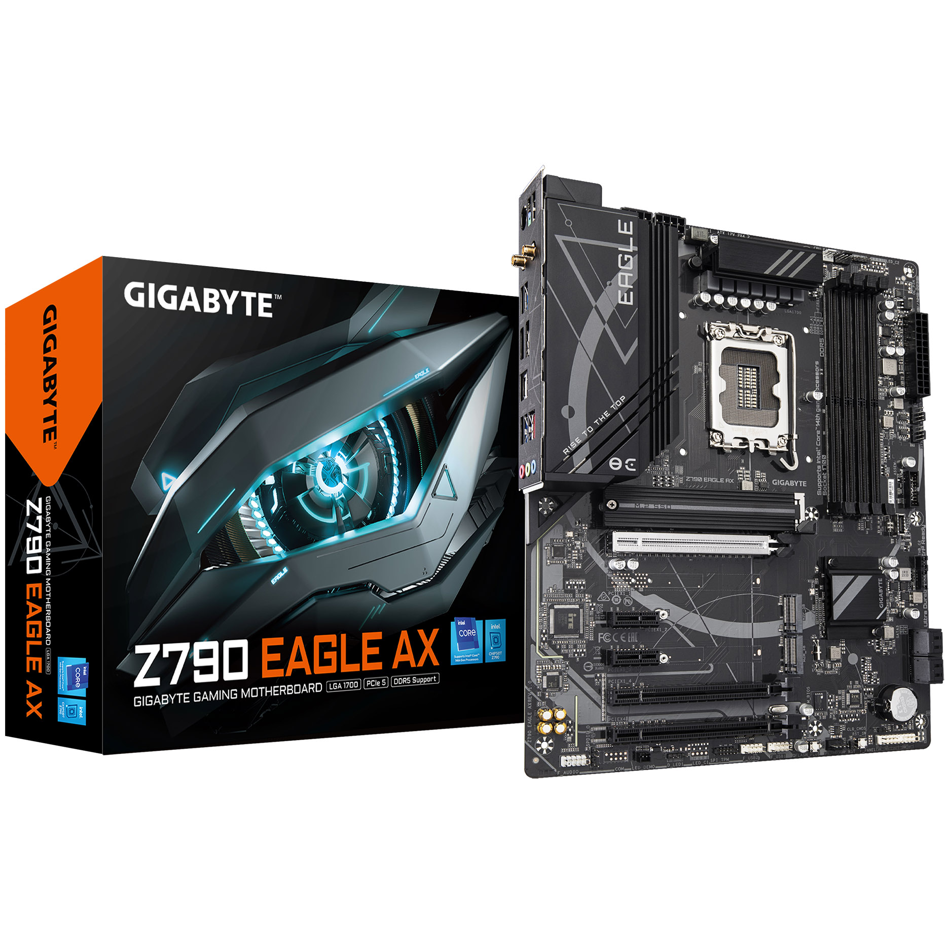

Would need more info on the productivity usage to be more specific with the build choices.
My basket at OcUK:
Total: £435.96 (includes delivery: £0.00)​
My basket at OcUK:
Total: £630.95 (includes delivery: £7.99)​
My basket at OcUK:
Total: £781.91 (includes delivery: £7.99)​
