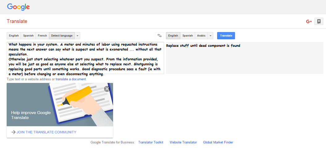

What happens in your system. A meter and minutes of labor using requested instructions means the next answer can say what is suspect and what is exonerated ... without all that speculation.
Otherwise just start selecting whatever part you suspect. From the information provided, you will be just as good as anyone else at selecting what to replace next. Shotgunning is replacing good parts until something works. Good diagnostic procedure sees a fault (ie with a meter) before changing or even disconnecting anything.
I'll do the honours..
