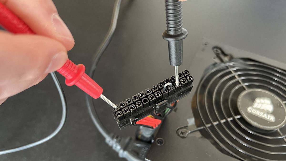

This guide is useful if you have a multimeter to test the PSU properly:
Handy site and easy to follow.
Just need a good multimeter now lol
As mentioned before, the PSU on its own may fire up, but if is faulty, won’t manage when feeding the system. Had this issue with an OCZ power supply and a Thermaltake, both ages ago.
