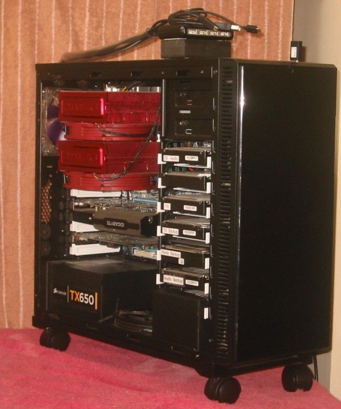

Nice to see the phantek fits that direction, i was thinking of rotating it to face into the roof.
