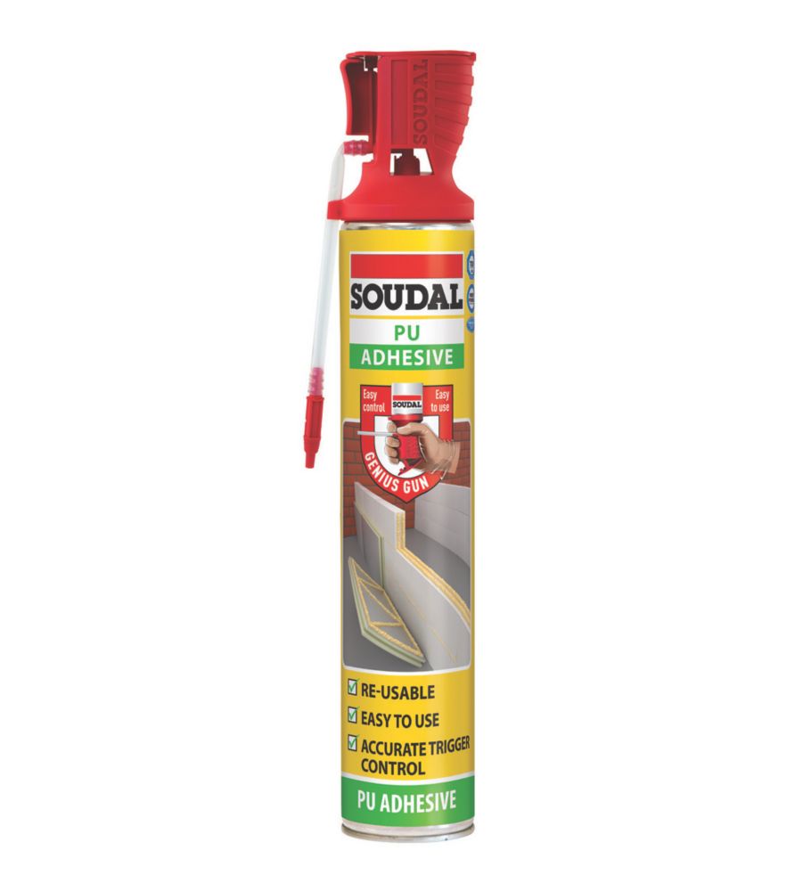

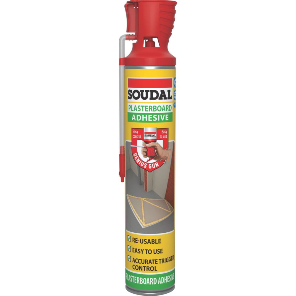

Not sure the difference but this one is specifically plasterboard adhesive and cheaper. But yes. I haven't used it before I still prefer full plastered walls rather than boarding.
Foam worked a treat @robj20 ! Probably could have gotten away with it as it was but it's solid as a rock now :cool: plus I got to shoot some foam, which was fun. Ended up going the whole hog and buying a proper gun.
