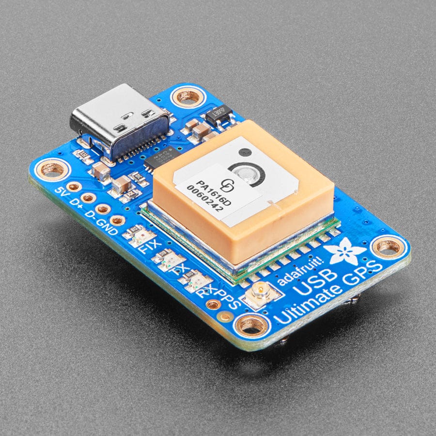

Looking at this GPS module which has a USB-C connector.
Can I plug this straight into the USB port and address it through gpsd or do I need to do something funky and connect it via GPIO?
I don't know anything about gpsd but the description says built in USB serial converter so it should show up as a serial port in /dev I'd think. I think this is how most GPS receivers work, as a serial device, and the protocol is also a standard so I expect it to be pretty much plug in, configure your port and off you go.
That was my thinking, I really just needed someone else to give me a sanity check, thanks.
It's a serial (over USB) module, so i don't see why it wouldn't. The only thing you might need to be wary about is different baud rates, as (iirc) GPSd defaults to 4800 whereas that module is 9600 - you can adjust this through the '-s' option though.
All sorted. Plugged it in, installed gpsd, added a line to /etc/default/gpsd that reads GPSD_OPTIONS="/dev/ttyUSB0", rebooted and it's working.
