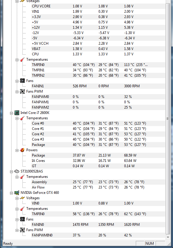

thanks for the quick responses, alright to run a few things here
the i7 came with a overclocked bundle I purchased from overclockers some months ago that came with a Corsair A50 This bundle, I stuck with the H50 as I thought it would be the better cooling option.
the cpu voltage is what it came as which is 1.36
currently while running world of warcraft cpu temps are around 39-43c while doing some heavy duty stuff in the game, the old republic cpu temps are the same as it is in warcraft and in call of duty the temps are also the same
these are the current levels while I am in star wars
