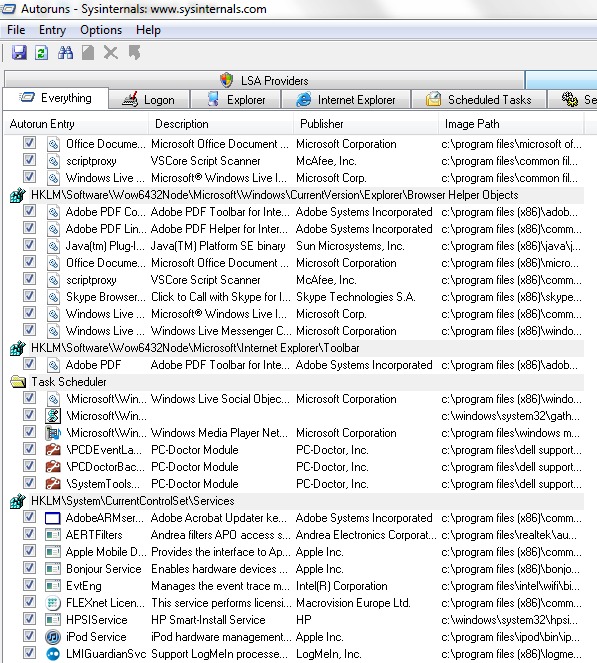

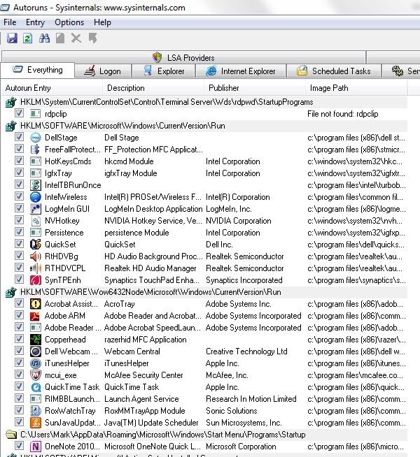

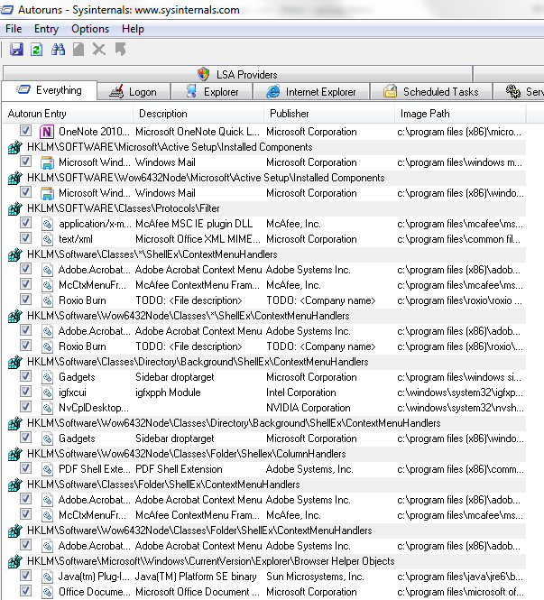

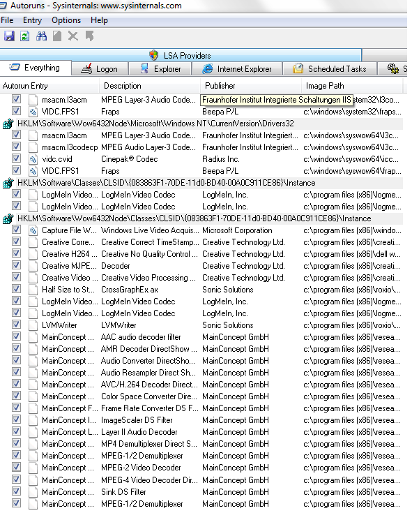

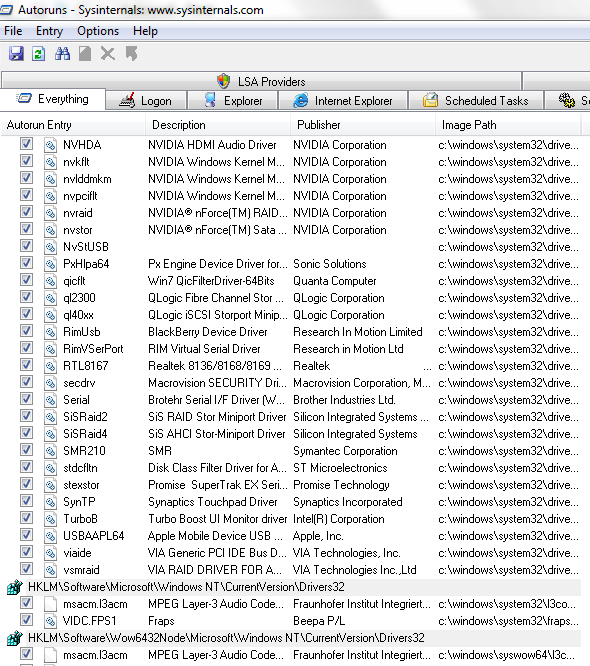

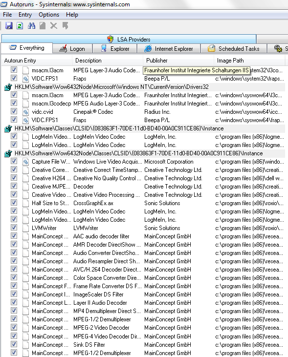

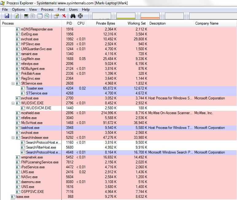

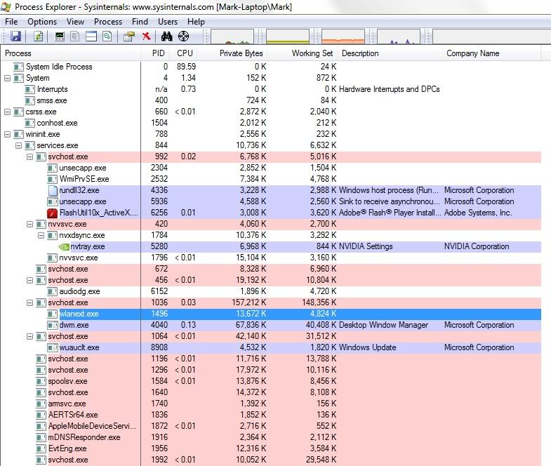

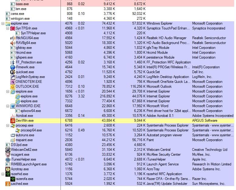

Process Explorer:

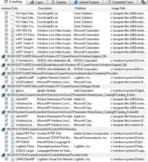

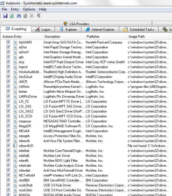

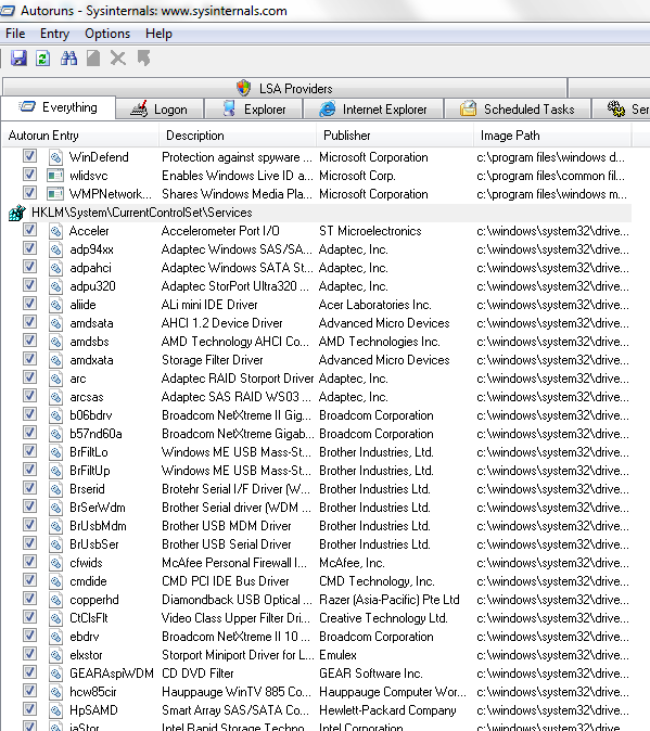

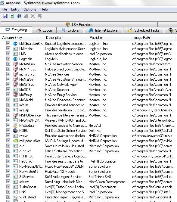

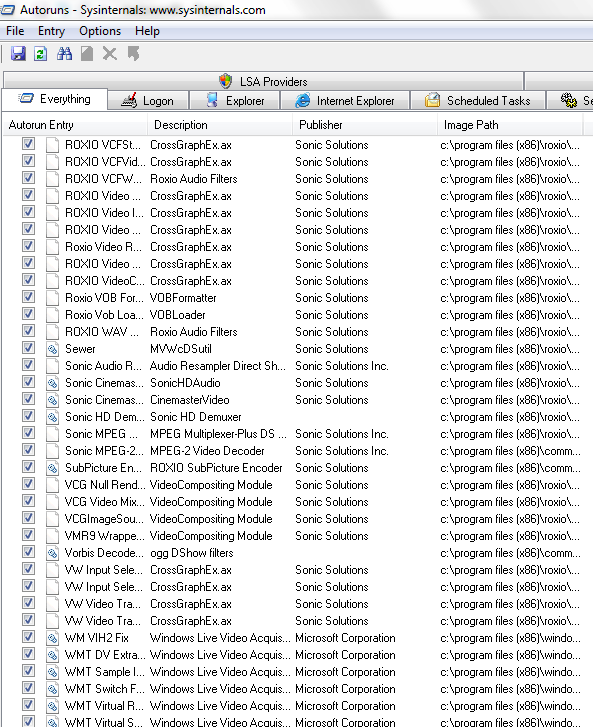

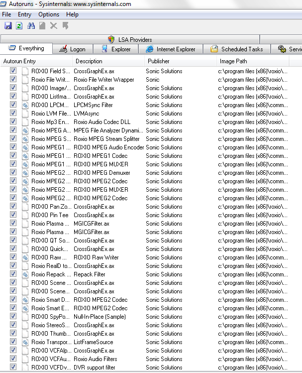

Autoruns to follow.
Also, did you run this as administrator? I find it strange that a lot of your system processes aren't labelled as published from Microsoft.
Thanks mate, will do some checking on those.
I'm logged on as administrator but did not run the exe using "Run as administrator".
Run as admin and tell me if the publisher changes.
Burnsy, just run as administrator, pretty much all the publishers are there now. On the four you highlighted:
unseccap.exe - Sink to receive asynchronous callback for WMI client application - Microsoft
wlanext.exe - Windows Wirles LAN 802.11 extensibility framework - Microsoft
SUGO2Langmon - No description and no publisher - says file does not exist if I try to view properties.
Microsoft\Windows\NetTrace\gatherNetworkInfo - No description and no publisher - says file does not exist if I try to view properties.
I've also run a Hijackthis log:

Unsecapp.exe - http://www.neuber.com/taskmanager/process/unsecapp.exe.html or http://www.whatsrunning.net/QueryProcessID.aspx?Process=1834
Wlanext.exe - http://www.whatsrunning.net/QueryProcessID.aspx?Process=16670
These look okay from what I can see.
Run your HijackThis log here for some help with it, but it looks okay to me (although I don't know what your unknown items are)... http://www.hijackthis.de/en
EDIT - I would also suggest that you give MalwareBytes and/or Spybot S&D a run through if you haven't done so already.
