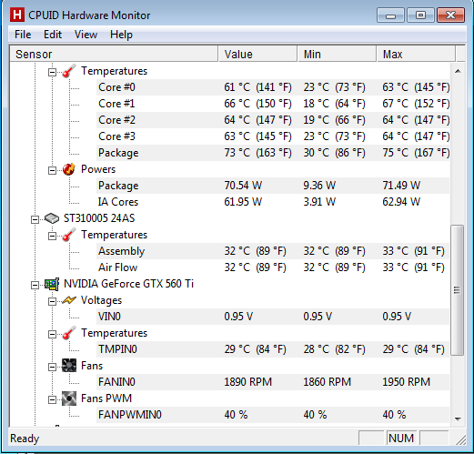

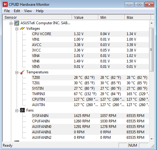

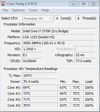

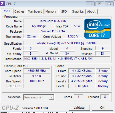

You need to use CPU voltage offset,and the right loadline calibration setting
Idk how your clocked atm,fixed or offset
But if it uses more voltage than you want/need then use less offset
I think it is on Auto atm. I`ll have a go at lowering it tomorrow. Right, that`s me done, I`m off to bed, will update later tomorrow. And thanks again, guys.

But I will continue this in the other thread. I just want to get the Vcore down as low as possible. Also, hot happy with the ram voltages, I have it set at 1.65v but it runs at about 1.663v, which it`s never done before.
