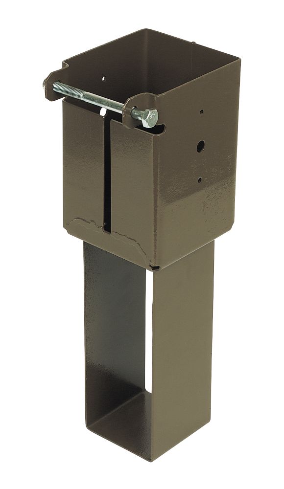

Anyone used postcrete with one of these Vs traditional concrete, is rather it set fast.
It's a tight fit hole so wondering if there is time to mix it up get it all straight before it sets.
I wouldn't personally use postcrete in your scenario. It's fine for resisting lateral movement when put around a post but the item you have linked relies on it being embedded within the material. The postcrete will likely break up over time. Given you are only filling a small hole I can't really think of any benefit of using postcrete over a bag of fast-setting concrete.

which of these products do you think is a stronger solution?
1) a metal u support bracket with 200mm rebar
2) a fencemate concrete in swift clamp

The worry for me with something like the fencemate is getting sufficient concrete tightly around it. Think I'd rather fill the hole with concrete then push in a u support with rebar.
Yes I think that's what I'll do.
Yes I agree. It would be a very snug fit with the fencemate but I was thinking that may aid the strength of the support. Nevertheless I'm going for the rebar and u support option and hopefully it will work!
