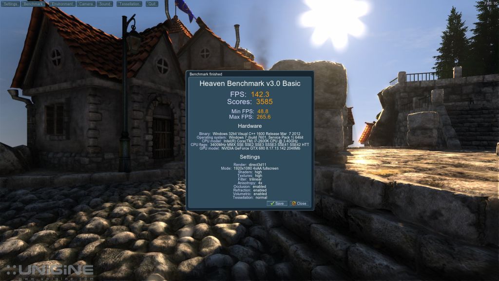

Talking of performance, here is my official Heaven run pushing these cards as near to the max as I had time for and surprisingly the temps were quite good bar the fans being 100%!!
GPU#1 - POV-TGT GTX680 Ultra Charged (Core: 1215MHz, Boost: 2430MHz, Mem: 1702MHz, Power: 112%, Voltage: 1.175, Temp: 70c@100% fan)
GPU#1 - POV-TGT GTX680 Ultra Charged (Core: 1233MHz, Boost: 2471MHz, Mem: 1702MHz, Power: 112%, Voltage: 1.175, Temp: 58c@100% fan))
CPU - 4.8GHz, 1.42vcore - validation
GPU-Z validation
Run #1 GTX680-SLI (all as above)
Score: 3908 - 1680x1050
Link to full-size
Run #2 GTX680-SLI (all as above)
Score: 3585 - 1920x1080
Link to full-size
