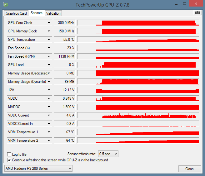

Ive done some playing about and it might be overheating the VRAM, it nudges low 70s yet the fans dont seem to speed up enough to compensate.
Edit - Here is a GPU-Z screenshot running Heaven Benchmark 4 at ultra, no crashes this time. VRAM 1 maxes out at 69 degrees and the fans highest is 30%.

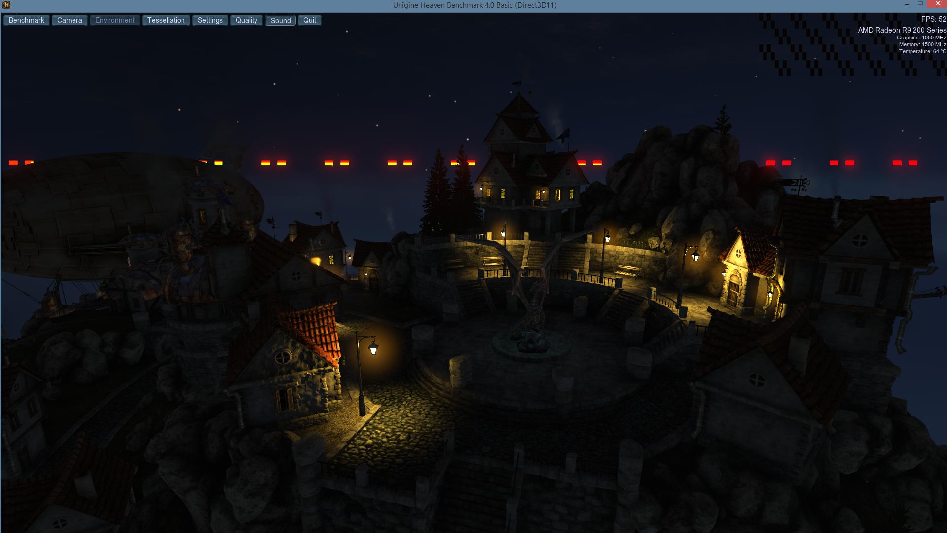

Just ran Heaven 4 for longer and got a crash, not long after completing one loop through.
VRAM1 this time reached 71 degrees and the fan speed was at 30%, then it crashed. GPU temperature reached 64 degrees.

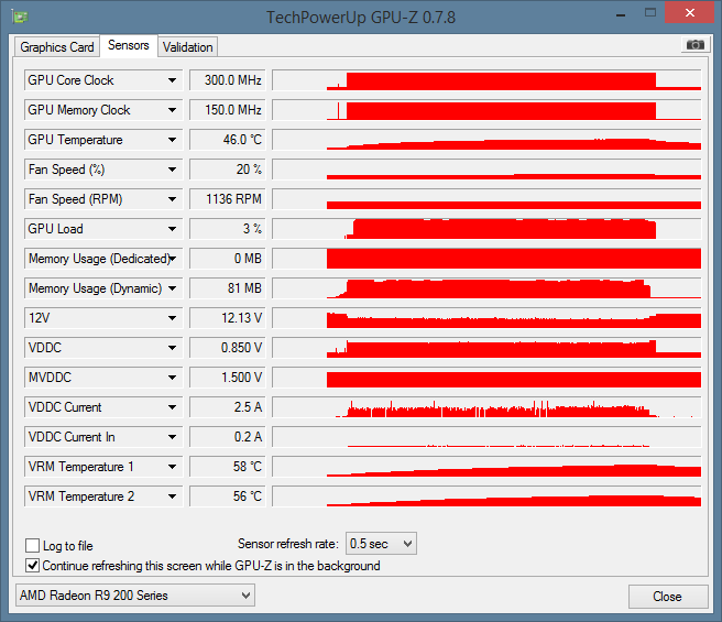

Quickly ran 3Dmark 11 basic and it crashed shortly after the 3rd scene, temps werent as high as Heaven, VRM1 was 64 when it stopped.

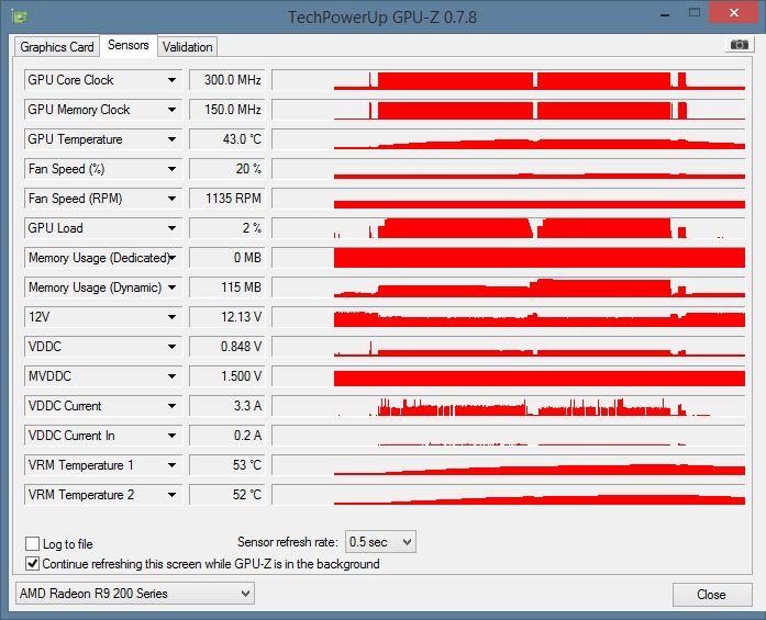

Righto ive clocked it down from 1050 to 895MHz and no crashes or artifacts as of yet. Got through 3dMark no problem and ran Heaven looping for about 15 minutes and no issues. Getting roughly the same temps as before so overheating doesnt seem to be the problem.
Edit - Just to confirm it would still crash at stock, it just started throwing artifacts into the mix as well.
