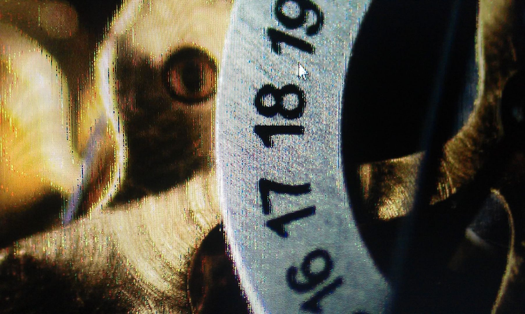

I made a post a few days back on the graphics section relating to an ongoing issue I've been having. They seem to believe it's another component and not the graphics card, so I'm posting here in the hopes someone might be able to impart their wisdom on me ;)
The original thread is here, I'm really frustrated but now that the seed of doubt has been planted I'm thinking it may well be hardware rather than software.
Just to outline the problems; graphics drivers crashing and restarting, applications crashing, PC restarting after screen messes up, hard drive corruption, after a while booting into Windows will give me just a black screen and a cursor, occasionally when powering on the fans spin but nothing else happens, Windows update fails to install certain patches, occasional graphical glitches without a crash. Another issue that is almost certainly unrelated (as it's happened to others as well) but might be worth throwing in, is that occasionally my sound card won't be recognised even by the driver installer (which reports no Xonar installed), as I say I'm not the only person to have suffered from this but might be worth noting.
The most recent issue I've had has been just now, playing Dirt the game kept locking up followed by the Windows pop up about changing to basic theme from Aero, obviously not as major as the other problems that crop up.
Something I read online was that a complete lock-up without a blue screen is indicative of faulty RAM, when my system crashes usually the picture screws up (imagine a smashed LCD with random splodges everywhere, that's what I get) then a hard reset.
