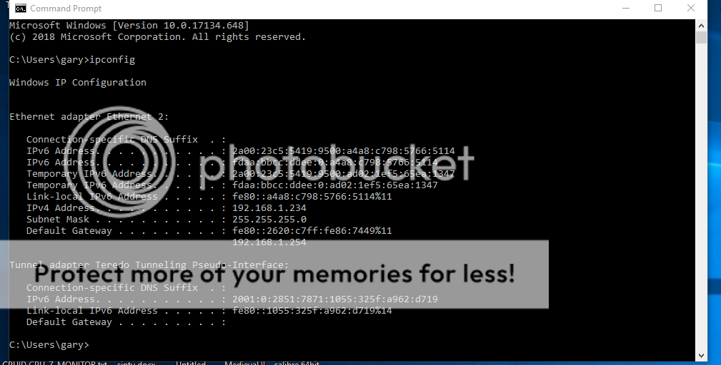

I can see in the BT router below that my downstairs pc (Gary-pc) is showing 192.168.1.234 but if i run ipconfig it shows 192.168.1.254
192.168.1.232 is the access point.
192.168.1.198 i presume is the switch?
What have i done wrong?
The 192.168.1.254 that IPCONFIG is showing is the gateway address (i.e. the BT router). The IPv4 address is shown further up.
